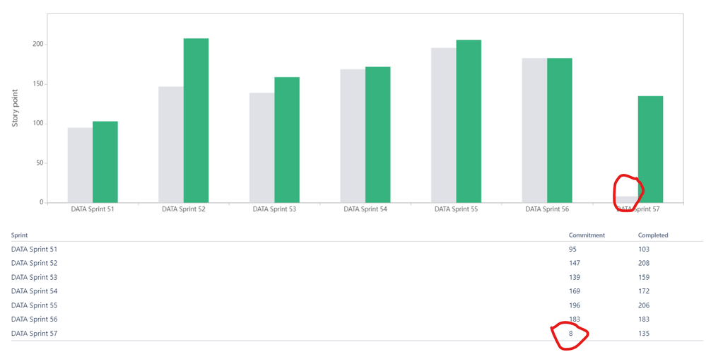

The initial commitment was 135 and when everything was done in the column the total was still 135. I did the complete sprint, but when I look at the velocity chart, the commitment is actually 8. That doesn't match the complete sprint. how to change 8 to 135 to match the one in complete? and what causes this to happen?

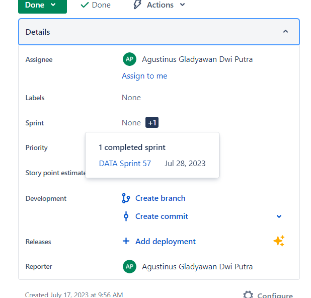

The "None+1" is a display introduced by Atlassian sometime now. Sorry I was not aware of that. But this display is not the source of your problem.

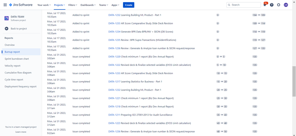

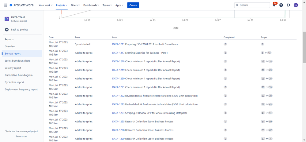

I see why the initial commitment was 8, this was the only issue in the sprint on starting.
All issues have been added after the sprint start.

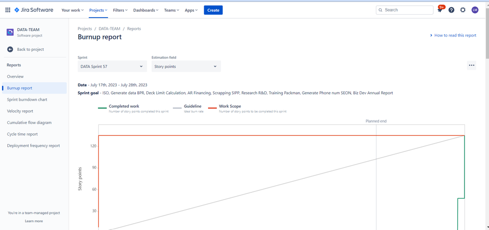

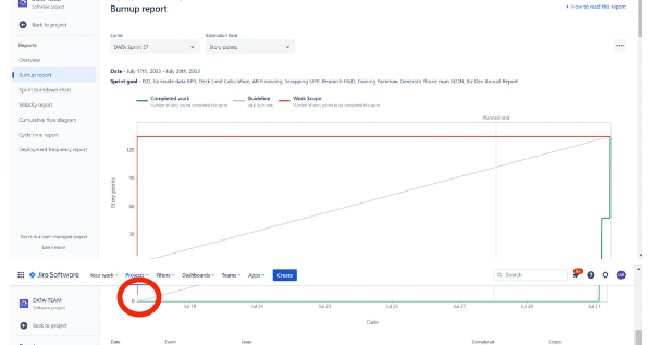

If they would have been in the sprint from the start your burn-up report would show the start to work scope at 135 not at 8.
You see the red line moving to 135 after the start.

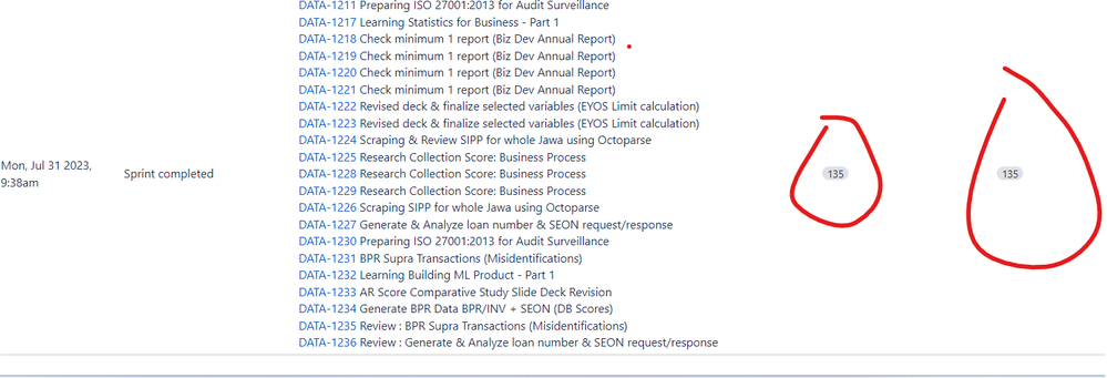

I completed the sprint, and the commitment should be 135 and the completed 135 on the velocity chart, but instead there are 8 and 135. See the part I circled in the screenshot above.

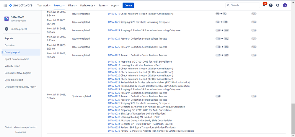

and look at what I screenshot below, here it counts 135 for compliance and commitment. but on the velocity chart the numbers are different

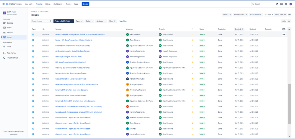

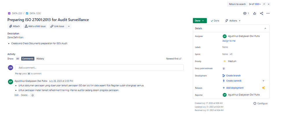

Check for example the issue DATA-1230. Can you verify that next to the status you see a resolution ?
In the screenshot bellow, you have status is Done and the resolution is Done.

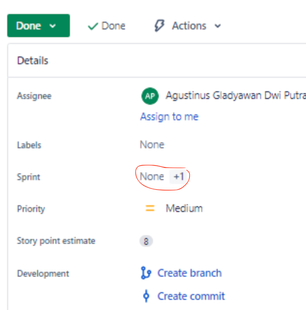

Hi @Loveleen Margareth ,
I see something unusual in your screenshot. The Sprint field in your issue is showing "None +1".
Can you edit the sprint field in this issue and check if anything changes in your report ?
Thanks,

As seen in the sprint report, you added on my request, I think that went wrong this time.
The red line in the report starts at 8 points and after start the line climes to 135, so all issues have been added after sprint start.
If all issues would be in the sprint from the start the line would have started at 135.
