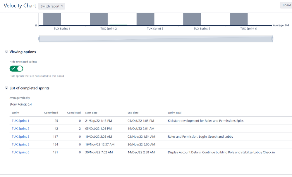

Sprint 4 is related to the board and the velocity chart still hides it after "Hide Unrelated Sprint" is turned on. Also, the completed green bar is not correct.
We checked the board filter and all the board configuration but couldnt find anything that would cause this.
The velocity chart on each of the boards in showing incorrect information.
Please check the attached images.hide unrelated sprint is on.pnghide unrelated sprint is off.png

Could you explain what you think is wrong with these reports?  (Other than showing that your team is not delivering what it should be)

Have you check from which board the sprint was created?  When enabled, that option only shows the sprints created from the board which you are currently viewing.
https://confluence.atlassian.com/jirakb/how-the-hide-unrelated-sprints-feature-works-on-a-velocity-chart-in-jira-1082273005.html
Regarding the completed work, have you confirmed the issues were in a status which is mapped to the right-most column on the board?  That is how Jira Scrum boards determine "done" for a sprint.

Thank you for your response.
I am not sure how, but the issue is fixed now.
