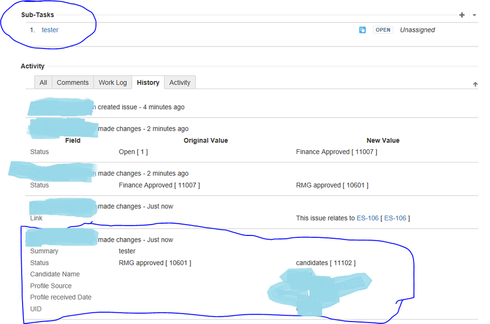

These entered values can be seen under the history tab.

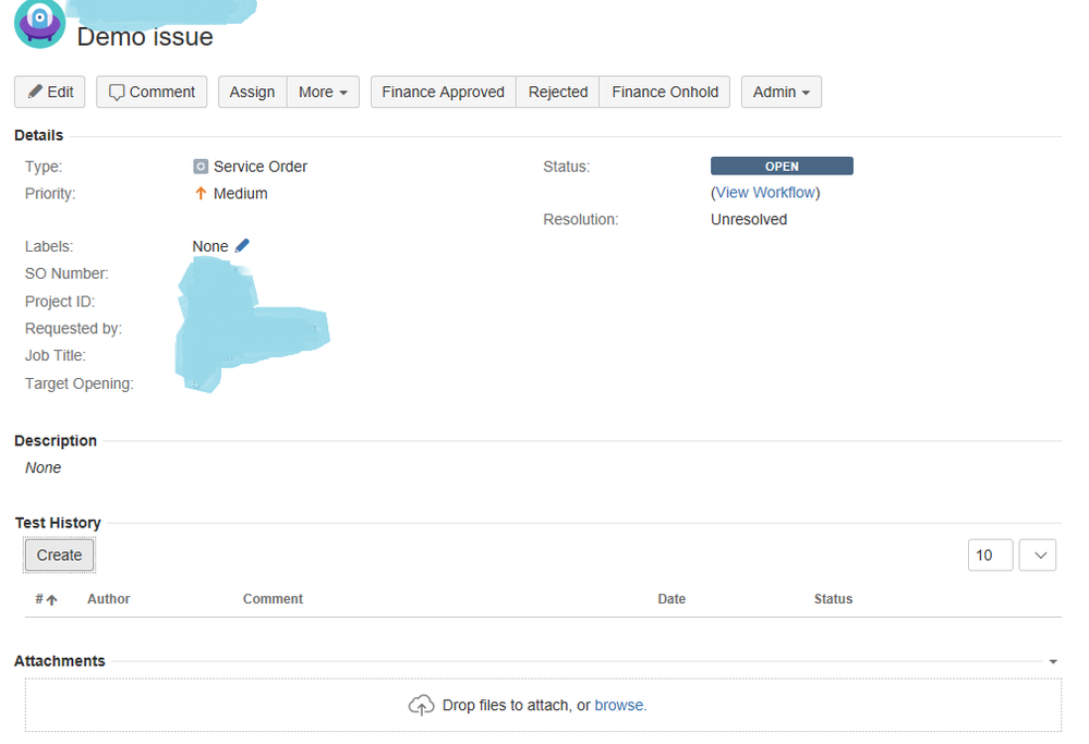

Thanks for the fast reply.  The below image is the issue view screen.issues page.PNG

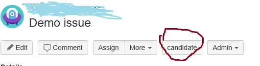

when the workflow goes on I reach the following state.

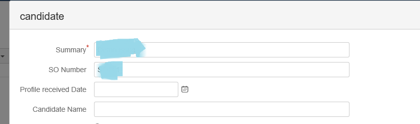

Then the following transition screen is shown, the screen created for the subtask.
Now the values are enter a subtask is created and the following happens.

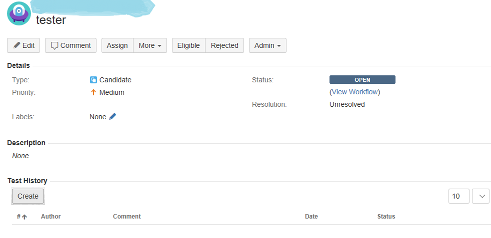

I thought that I will get the value in the subtask view screen but the following was shown.subtask page.PNGAs you can see only default fields are shown here.
I want that custom fields to be displayed in the subtask view screen. What to do?

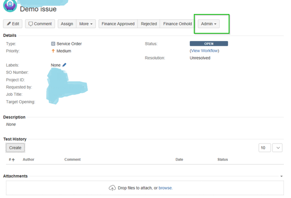

Hi @Ishwarya Mani, click on the "Admin" button on the view screen (highlighted in green), and it should help you find the data. Look for "Where is my field?"
