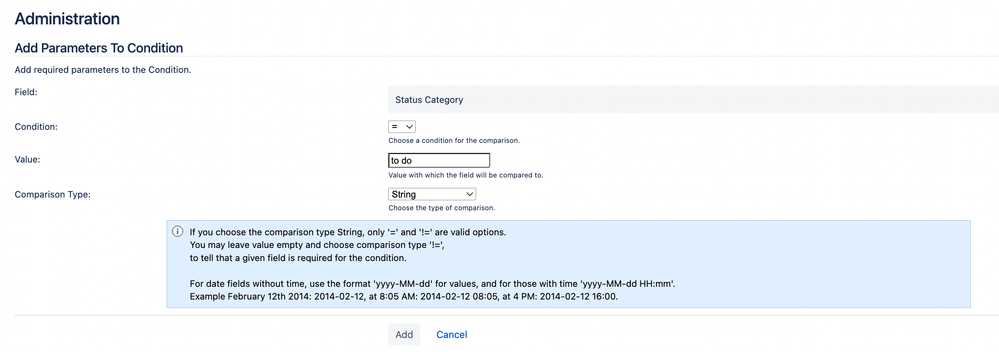

I recently got rid of JMWE and Scriptrunner on one of my client's instances and I am trying to facilitate most of the advanced configuration and automation with out of the box features.
In regards to a specific case (conditional handling of transitions based on the current status or current status category), I have found the only option to achieve this is by using Value Field Condition.
Unfortunatelly after trying all the possible combinations of strings and Option IDs for statuses and categories using '=' operator. I can't seem to get this thing working. Can someone help me to find the right configuration for this?
Examples:
- Status Category | = | id=2 | Option ID
- Status Category | = | 2 | Option ID
- Status Category | = | new | String
- Status Category | = | "new" | String
- Status Category | = | to_do | String
- Status Category | = | "to_do" | String

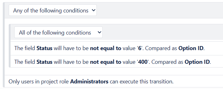

We had a similar need today, and unfortunately Status Category was not working in workflow conditions. (which is a bug)
I suggest you put all the statuses you want to allow in an "Any of the following conditions" block or all the statuses you want to exclude in an "All of the following conditions" block.
In the end this is what works for our use case :

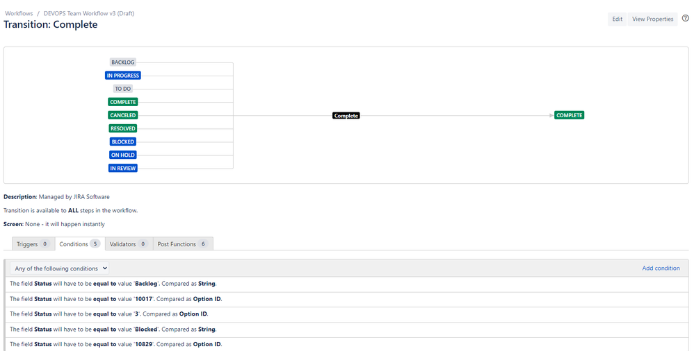

Hi @Matus K
I know that might be late, but I was working in a scenario similar to yours.
My problem was that I was not able to make a condition with Status field, by using != and then as string.
My case is I dont want the issue to back to Complete if in "In review", "Resolved", Canceled Status.
Also found that the "In progress" status as string does not match because of the space. Tried with " and ' no results.
So I changed some to option ID and got the status ID from Admin
THis is my screen
Sounds to be easier when doing directly by status category, but using = status was the only way to work for me.
I hope this helps.

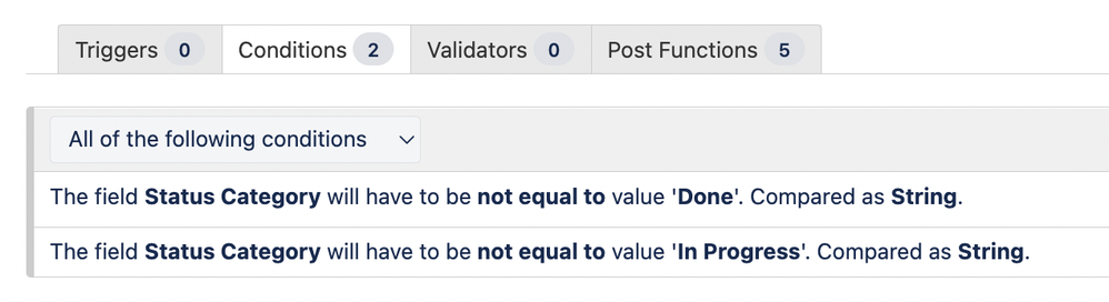

Hmm; after testing it I must say I am a bit puzzled as well. I did not succeed in making this work with status category = To Do. I am wondering if that may be a bug.
Anyway, the following workaround did work successfully in a test environment:

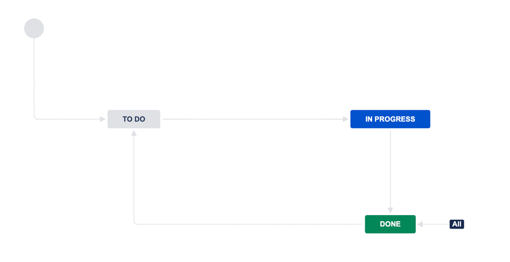

I am sorry, @Matus K, but you have lost me there. I am getting the impression that you are trying to use conditions on global transitions (those are transitions from a black All lozenge to a status) to disable certain transitions you don't need.
If that assumption is correct, why don't you simply replace the transitions you don't need by actual, direct transitions between statuses like this:
That way you won't have to bother about hiding them conditionally based on status (category) at all.

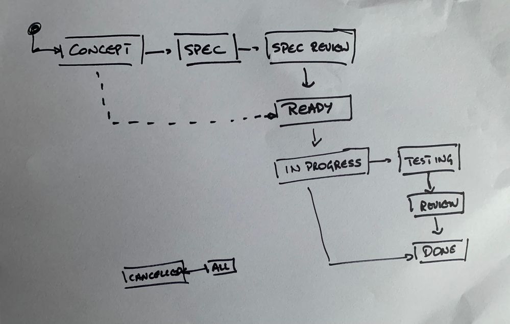

That is what I was thinking indeed. So: get rid of the -> All transitions and redesign your workflow somewhat like this:
You won't need any conditions anymore, except (if you want to be really exact) on the transition to Cancelled. It would make sense there to restrict that transition by applying Status Category != Done.
