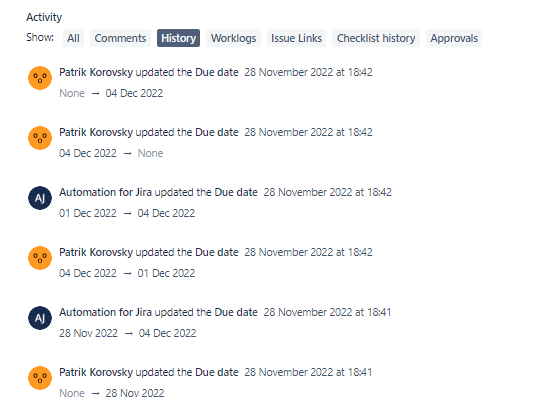

I propose an automation that sets the "Due Date" field to the next Sunday based on the input. The change is observable after a refresh.

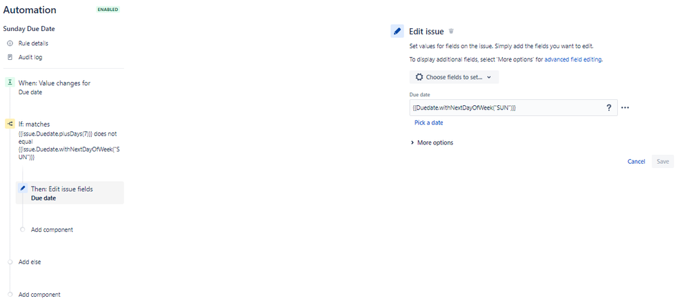

Automation setup:

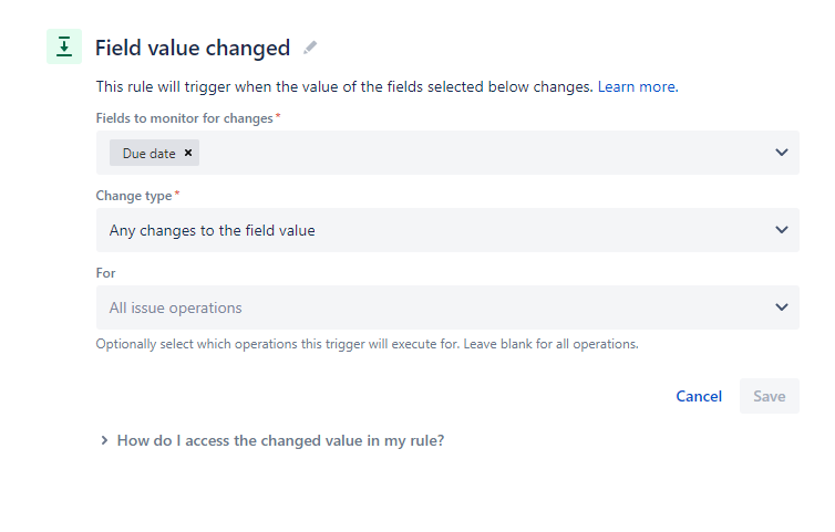

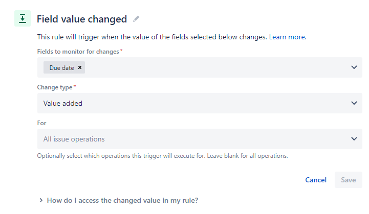

  1. The trigger will be "Field value changed"

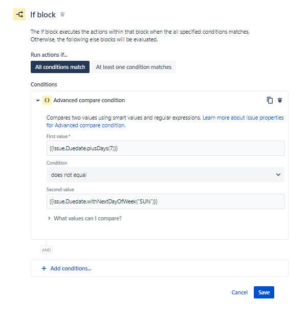

  2. We will add an "If block" so that if we set the Due Date on a Sunday it will not be set to the next week's Sunday, but remains on the selected date. The Advanced compare condition will be:
    1. {{issue.Duedate.plusDays(7)}} does not equal {{issue.Duedate.withNextDayOfWeek("SUN")}}

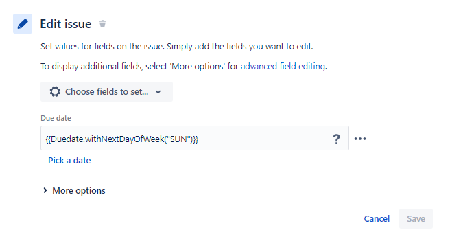

  3. The action will be an "Edit issue" and we will set the "Due date" to be a smart value "{{Duedate.withNextDayOfWeek("SUN")}}"

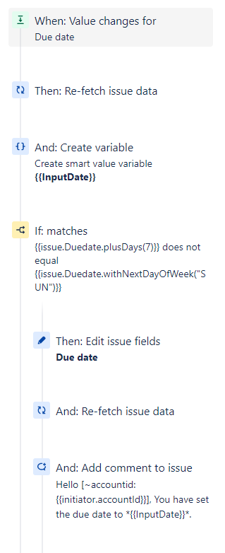

The full automation looks like this:

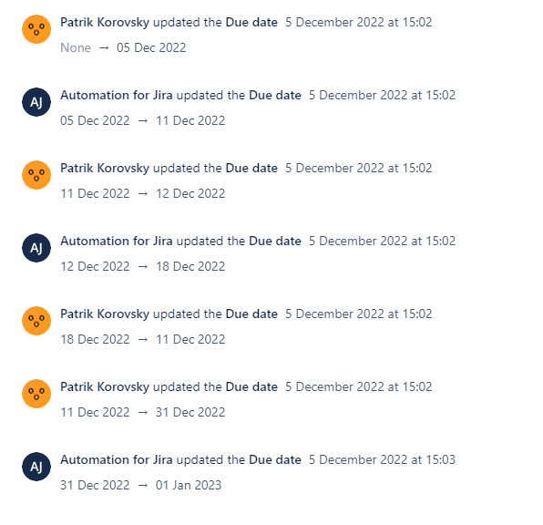

Result
  • Automation changes the date

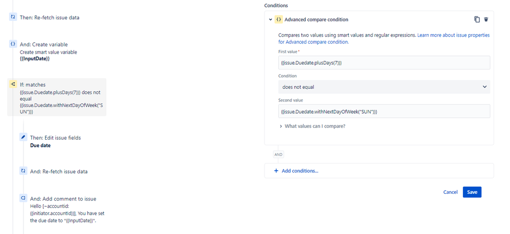

Here is the full setup with a recommendation:
  1. Field value changed (Trigger)
  2. Re-fetch issue data (Advanced action)
    1. (Optional, we need it so the automation can properly comment)

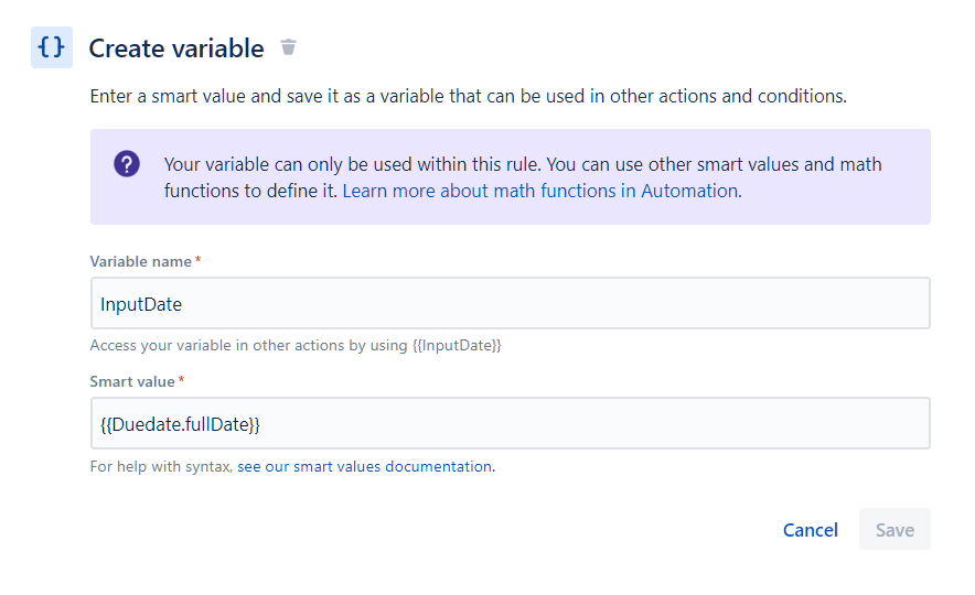

  3. Create variable (Advanced action)
    2. Choose a variable name (I chose "InputDate")
      1. Choose what your variable saves: {{Duedate.fullDate}}
  4. Create an if block where:
  5. Edit (Action)
    1. Due date to "{{Duedate.withNextDayOfWeek("SUN")}}"
  6. Re-fetch issue data (Advanced action)

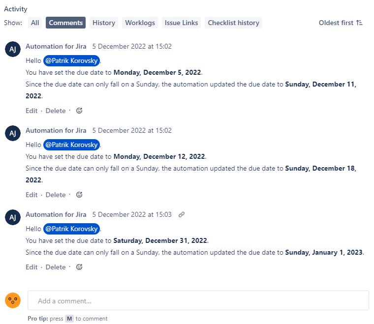

  7. Add a comment (Action)
    1. (Optional)
    2. The comment will read: Hello [~accountid:{{initiator.accountId}}],
      You have set the due date to *{{InputDate}}*.
      Since the due date can only fall on a Sunday, the automation updated the due date to *{{Duedate.fullDate}}*.
    3. Note that the "InputDate" depends on the name you chose in step 3.

Neta Knyazhansky Caspy
December 5, 2022
You are the BEST!
The only thing that isn't working is the InputDate in the comment, it looks like this:
"You have set the due date to **."
I guess something needs to be changed in step 3?

Can you please share how you approached the third step?
If I follow my example it should look like this:
  • Note that you have to specify the "Due Date" date format in the variable when creating it, not later on in the 7. step (that would not work)
December 5, 2022
I found what wasn't configured correctly.
I didn't realize the configuration is case-sensitive so the Variable name in step 3 didn't match the syntax in step 7.
I fixed it and it's working perfectly now.
