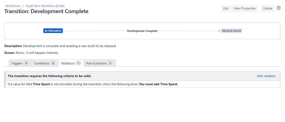

can u share screenshot of your validator? at what point in the process did the time get logged?
Dylan Riley
May 18, 2018

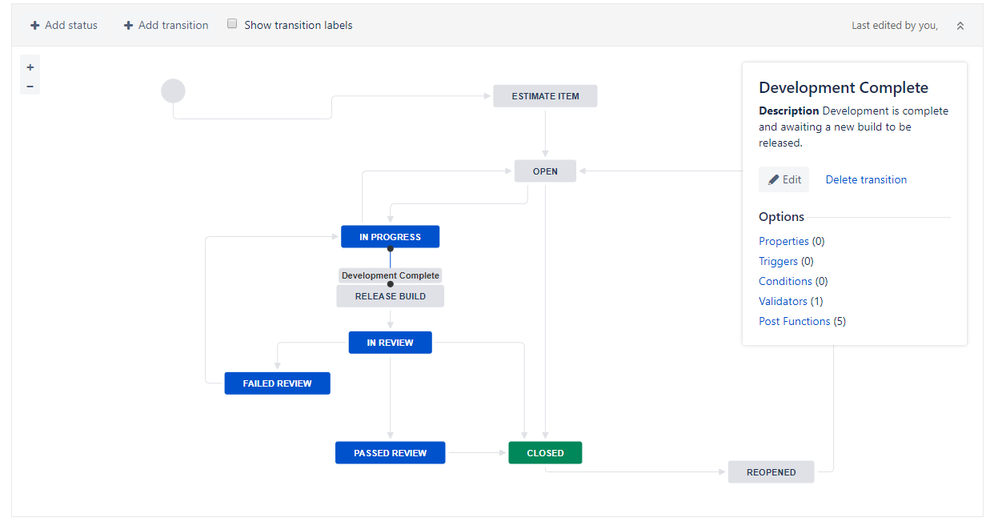

The time was logged earlier in the workflow, maybe that's the issue. But I did log work at the time of the transition to see if it would fix this issue and it didn't.
workflow:
validator:
validator01.pngThanks!

Jack Brickey
May 18, 2018
understood. the current validator requires that the user log time when transitioning. For this to work you need to have the transition screen actually present 'log time'.
I think what you want is to ensure that time spent is not empty if the user transitions?
If so try the following on the transition:
  • Use Condition
  • select "Value field"
  • select time spent and set to not equal 0
or something similar
Dylan Riley
May 18, 2018
Awesome, that's it! Thank you so much!
