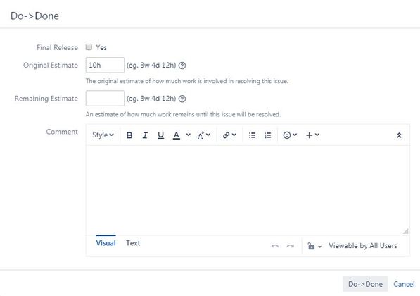

When starting the transition, the following screen shows:
2019-07-10 14_44_09-Do-_Done - DBG JIRA.jpgBy default, the "Remaining Estimate" is empty.

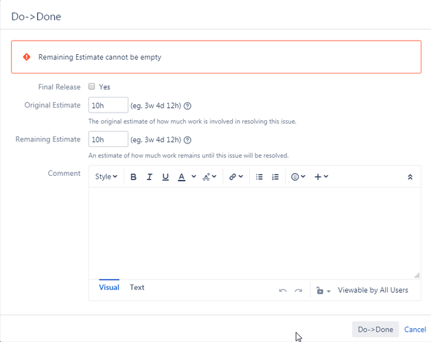

I just ran a test to see if the getEstimate works and the validator
issue.getEstimate() == 3600
 returns the following after confirming:
The error message was defined by me, so no worries there.
Obviously the validator works now.
I noticed that I left the remaining estimate empty, then clicked, and suddenly the remaining estimate is automatically filled with the original estimate and the error message shows.

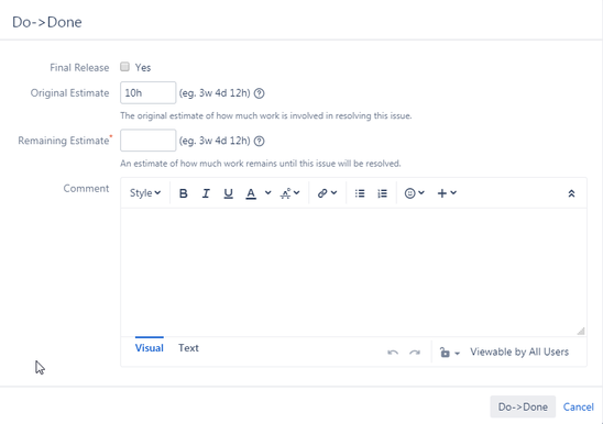

I also tried using the following validator:
Fields Required (JSU)
  • Required fields:
    • Remaining Estimate
  • Error message (optional): Remaining Estimate cannot be empty
This results in the following screen:
Remaining estimate now looks like a mandatory field, I am still able to simply confirm the transition and it will run just fine and fill in the original as the remaining automatically...
