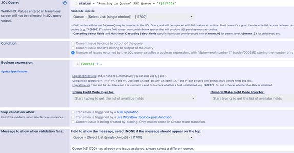

I got through your long post and survived! ;) But your use case is not that complex, so don't worry and let me try to help you with a possible solution. I'm not sure if you already use Scriptrunner or just plan to, because my solution uses our own app Jira Workflow Toolbox to achieve your goal. Shouldn't take you more than ten minutes to set this up.
  1. Add a Validation based on JQL query validator to your transition.
  2. Configure the following JQL query in the validator: status = "Running in Queue" AND Queue = "%{nnnnn}", where "nnnnn" is the field code/number of your custom field "Queue" so the selected value will be incorporated in the JQL search. In my case, it was the {11700}.
  3. Select the "Number of issues returned by the JQL query satisfies a boolean expression" option, so we can validate with "{00058} < 1" that there are no other issues already in that status and queue.
  4. Define a message to show to the user and translate it if necessary. You can integrate the selected value from the field here using field codes as well.
I attached a screenshot of the configuration:
 I hope this was helpful. If you're not just thinking of a groovy script solution but really want to write one, then I'm sorry for not providing the exact solution but the overall idea can be used in a script as well :)
Best, Max

thank you so much for your detailed answer! We're evaluating Add-Ons atm, so we will consider giving Jira Workflow Toolbox a try. We have several other use cases that we are solving with Scriptrunner at the moment, thus we were looking for a solution with a Groovy script. But of course it would be nicer to have everything in a configurable UI. We still have to check how much flexibility we really need in trade-off for easy usability.
I will try your solution tomorrow, thanks again!
