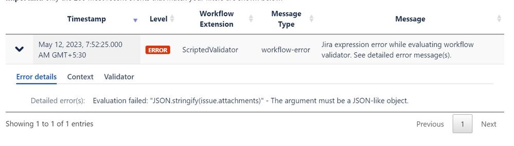

@David Fischer - Please find the error details after performing the transaction with the given script.
Sorry, my bad. Can you check this script instead:
JSON.stringify(issue.attachments.map(att => {filename:att.filename, mimeType:att.mimeType}))
and report the error here?
