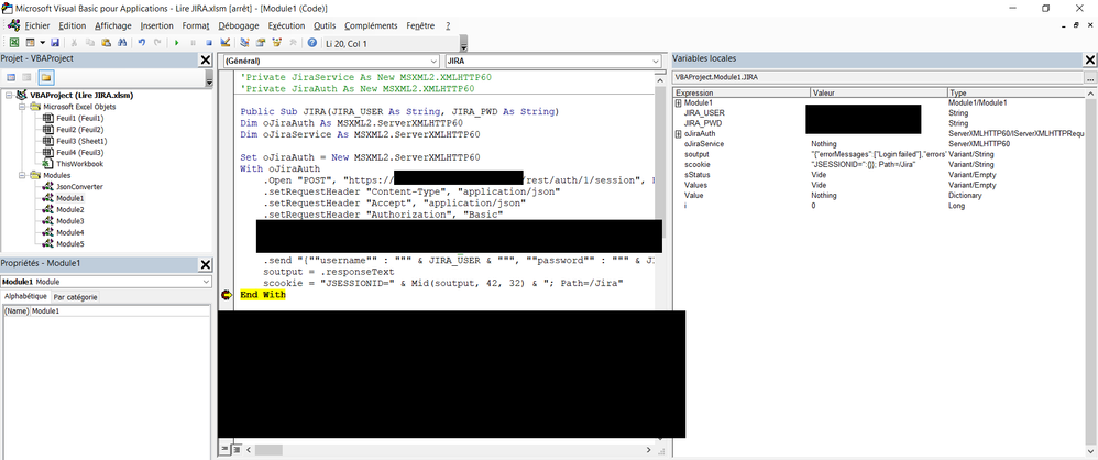

Hello Jira Community
I am trying to develop a little Excel tool to access to Jira's table and hopefully be able to modify several records at once depending on epic and other criterias.
But for the moment I can't log in to the database.
it always return to VBA "Login Failed" even if I followed the code proposed here : https://community.atlassian.com/t5/Jira-questions/Access-JIRA-with-VBA-Excel-2010/qaq-p/590003
Is it possible that there is a setting that has to be enabled to authorize external connections? (this is a cloud jira)
Best regards
