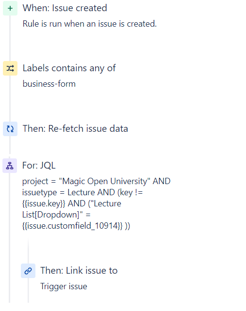

This is my Automation so far

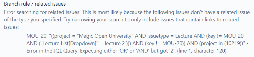

Error in Audit Log
Many thanks in advance for your time and help
Bill Sheboy
October 18, 2023
Reviewing that error message, we can see that the values in your Lecture List field have embedded spaces, such as for "lecture 2".
And so the JQL for the branch needs to have quotation marks around the smart value to handle that:
project = "Magic Open University"
AND issueType = Lecture
AND key != {{issue.key}}
AND "Lecture List[Dropdown]" = "{{issue.customfield_10914}}"
