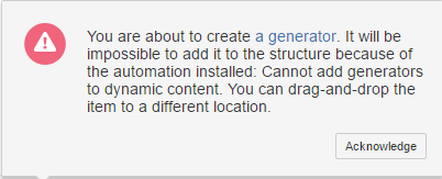

However, when I try to Group by Parent Link from Portfolio for JIRA, I get the following error:
What exactly does this error mean?

Hey Randy,
Sorry for delayed reply (we're still trying to figure out the new site and notifications).
When you add a generator, it is important to select the parent node correctly. The generator is added under that node and affects the part of the structure under that node. In your case, it seems that you were trying to add a generator under another generator, which is not possible. The message tells you also that you can drag the generator as a normal row to a correct position.
Kind regards,
Igor
