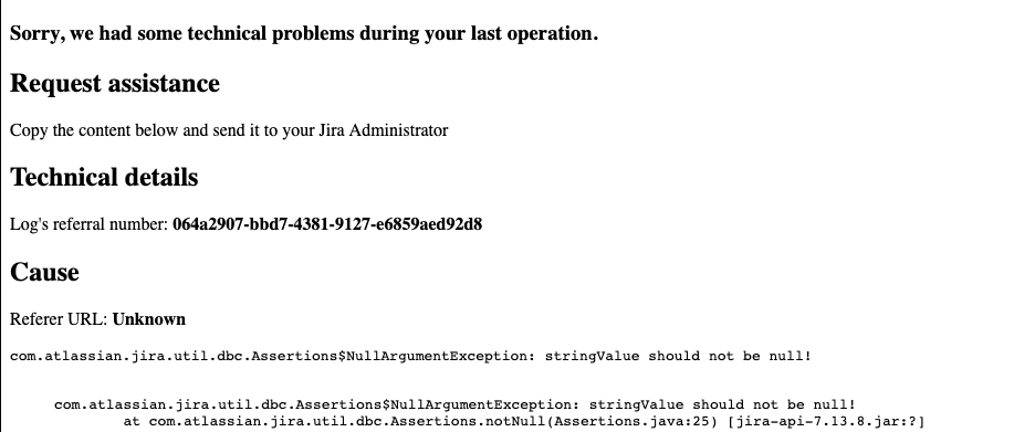

but when using the URLs below with "10567793" for the custom field as:
- https://<base JIRA URL>/issues/?jql=%22EPC%20ID%22%20%3D10567793
or
- https://<base JIRA URL>/issues/?jql=cf%5B29315%5D%3D10567793
getting ERRORS:
Does anyone have an idea what is wrong?
Trifon Anguelov
August 31, 2020
Had to do extra " " around the custom field and value as:
?jql="EPC%20ID"%20%3D%20"10567793"
instead of the URL suggested by JIRA as:
Probably a bug that needs to be fixed.

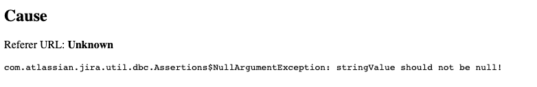

Trifon Anguelov
August 30, 2020
Cannot load the URL from the browser:
the custom field "EPC ID" is cf[29315]
The intended query is:
issues/?jql=cf[29315]=10567793
still getting the error:
If I use JIRA search bar, it works but not from a browser by using the URL: issues/?jql=cf[29315]=10567793

Trifon Anguelov
August 30, 2020
Adding more text from the error message in Chrome and Safari:
Sorry, we had some technical problems during your last operation.
Request assistance
Copy the content below and send it to your Jira Administrator
Technical details
Log's referral number: d3a0e0fa-3e6d-44ed-9c15-1374a6e72f44
Cause
Referer URL: Unknown
com.atlassian.jira.util.dbc.Assertions$NullArgumentException: stringValue should not be null!
