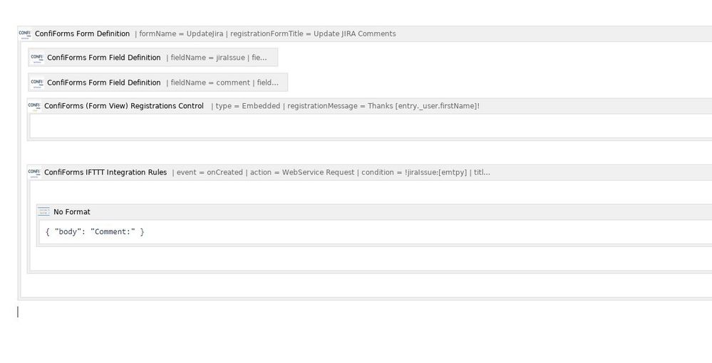

I am trying to use confiforms to add comments to an existing JIRA task.   I already have the form to create the JIRA task which works great.  I want to be able to then take the ticket number (example IOG-7567), plug that into a text box, and then add a comment and click submit.  It should then add the comment to that ticket.

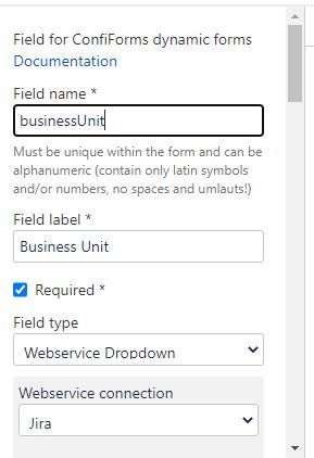

Have you set up a connection in ConfiForms to your Jira?
This tutorial shows how to do it in details https://wiki.vertuna.com/display/FORMS/How+to+create+a+form+to+create+a+Jira+issue+from+Confluence
Daniel Klingseisen
February 10, 2021
Yes, it is called "Jira".  This is the one I use for the create task that is working. This is also the one I selected for the new form that does not work.

This is what I have set up on the non working one:

How is this "web service request" IFTTT is configured?
