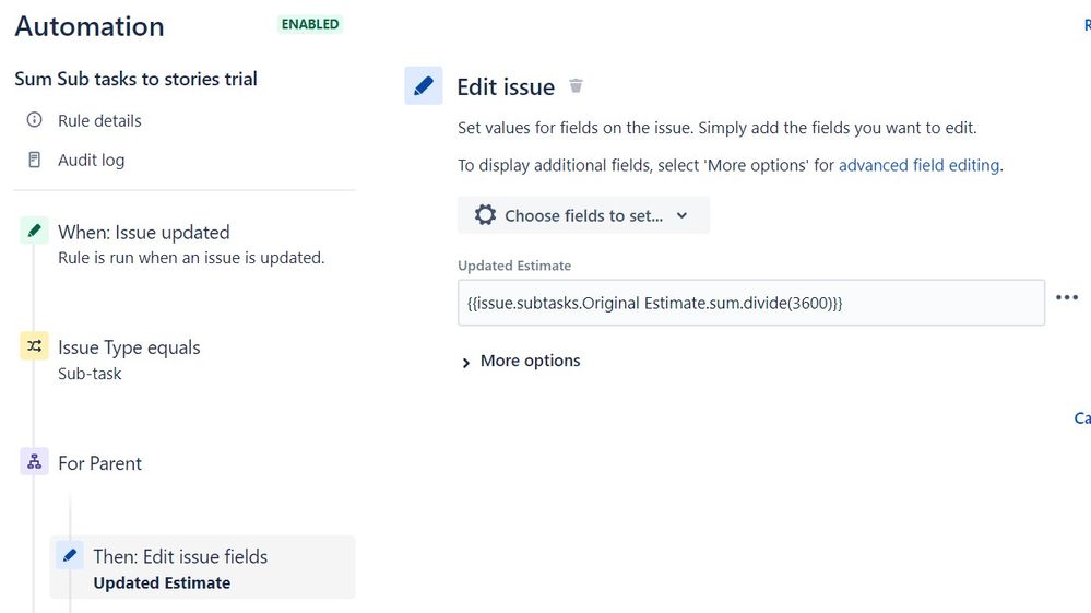

Thank you for your answer. This is my complete rule:
I'm trying to sum up the subtasks' original estimate to a custom field "Updated Estimate" in the parent stories.
When I enter a rounded hour for example 2 hours it works fine and I get the number 2, but when I enter for example 30mins it rounds to 0, 1.5 hours is rounded to 1.

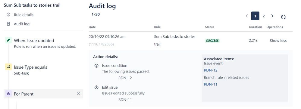

What is the type of your Updated Estimate field?
If you write that smart value expression (used in the edit) to the audit log, what do you see as the value: the rounded one, the unrounded, or something else?

This is an image of the audit log when I changed the Original Estimate of the subtask to 30mins. I'm not sure I understood you correctly

What I believe is happening is because Original Estimate is an integer (number of whole seconds), that type is being used for the rest of the expression.
To break that typing-chain and use a non-integer, try a math expression, such as this:
{{#=}}{{issue.subtasks.Original estimate.sum}} / 3600{{/}}
Nitzan Matalon
October 20, 2022
That worked perfectly!
