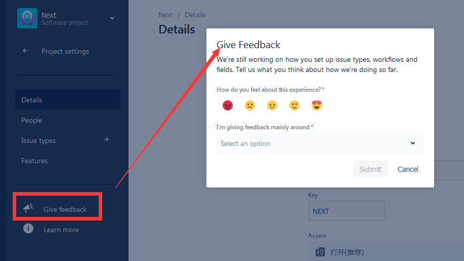

Hi @Hugh Evans,
I am not sure if multi-sprint function is supported in next-gen projects mode. You can refer to the following article:
https://community.atlassian.com/t5/Agility-articles/Everything-you-want-to-know-about-next-gen-projects-in-Jira/ba-p/894773
Or you can directly report your questions to Atlassian Team online.
