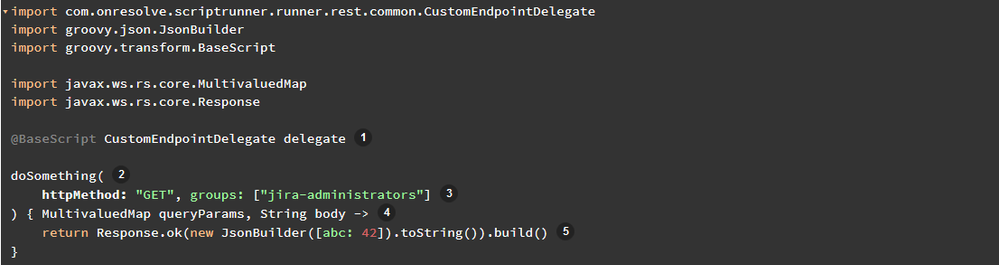

Here is an image:
Just image me System.out.println("Test") right before the return statement.
And that I called
<jira_base_url>/rest/scriptrunner/latest/custom/doSomething
on a button click. That basically what I did, got a success for run, but no log message.

Ok, I'm a bit stuck, because I get "Test" dumped into the application log when I use that code.

Yikes, I'm away from my work computer but application log you're looking at? I put this code in the service endpoint script and did a GET request to make it fire and when I look at the logs, I didn't see anything. Can you please provide me with a screenshot? Maybe I'm looking at the wrong spot.
