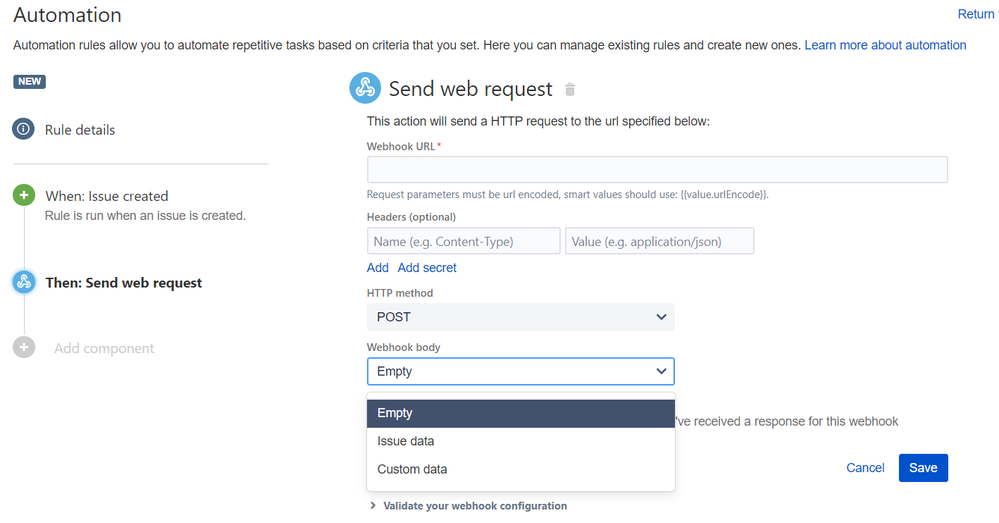

Hello @serge calderara ,
You can use Automation for Jira as well. End points can be customized.

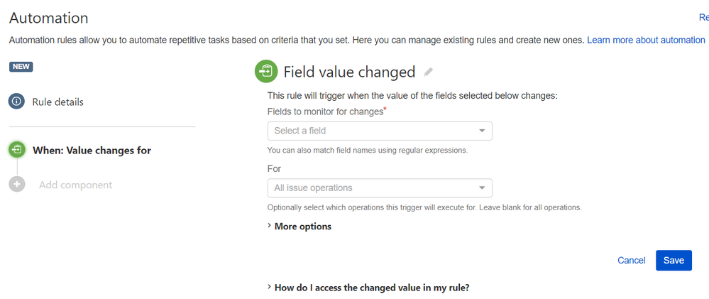

For update also, you have to decide on which field value update you want to send update.

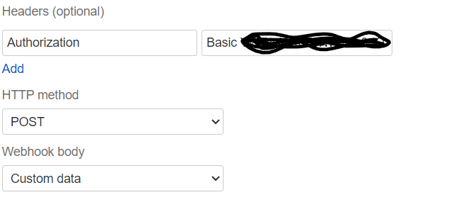

October 4, 2024
Q1 : Does the web hook end point can use only token as part of the URL or is it possible to have basic auth ?
Authorizations can be used like below:
Q2 : When an CREATE / UPDATE even is trigger in web Hook, does the all issue fields are send as the body or can the body be customized ?
ANS: You can keep it as custom data.
Q3 : When UPDATE trigger is use and Comment field is set for update, does only the comment field is send as body to the endpoint or does it send all time the full issue fields ?
ANS: If you have customizations, you can choose it.

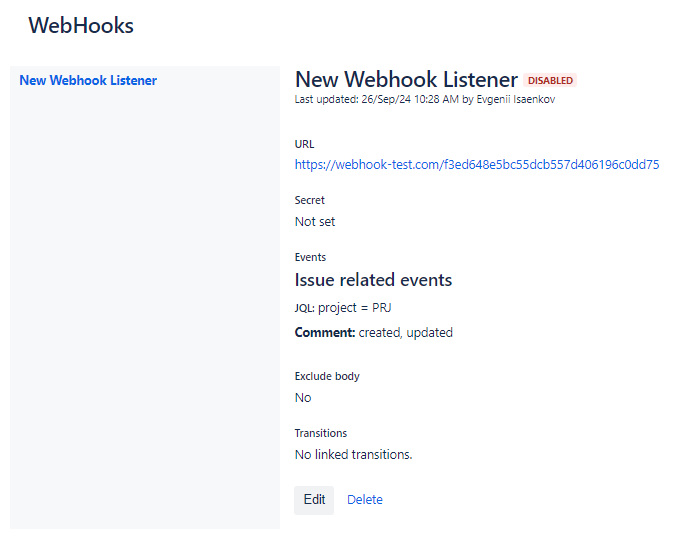

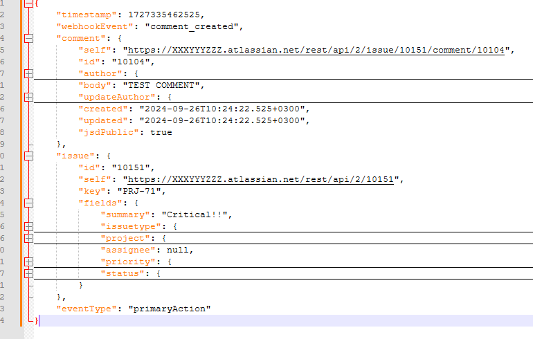

You can test it by yourself. Just google "webhook online testing tool". There are many such services. They'll give you url, which you add in Jira, and send there events.
For example, I used such service, and received next answer for comment event:
Why it's better to use automation for me - it's more flexible in configuration. You can change request body.

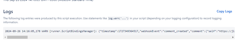

Evgenii
September 26, 2024
It was easier than I thought
https://yourjira.domain.xyz/rest/scriptrunner/latest/custom/getWebhook
import com.onresolve.scriptrunner.runner.rest.common.CustomEndpointDelegate
import groovy.transform.BaseScript
import javax.ws.rs.core.MultivaluedMap
@BaseScript CustomEndpointDelegate delegate
getWebhook(
httpMethod: "POST") { MultivaluedMap queryParams, String body ->
log.warn(body.toString())
SERVER
VERSION
9.12.12
