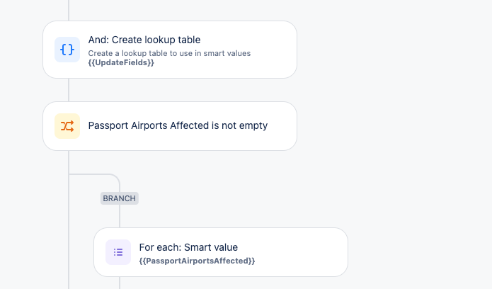

Sort of. I am looking to get the id from a webhook response and assign it to its corresponding variable. I am looping through a checklist. Here are a few screenshot that may or may not help!
Rather than expand on them all I will go through the first example as they are essentially doing the same thing with me just thinking of different ways to try and achieve the same thing!

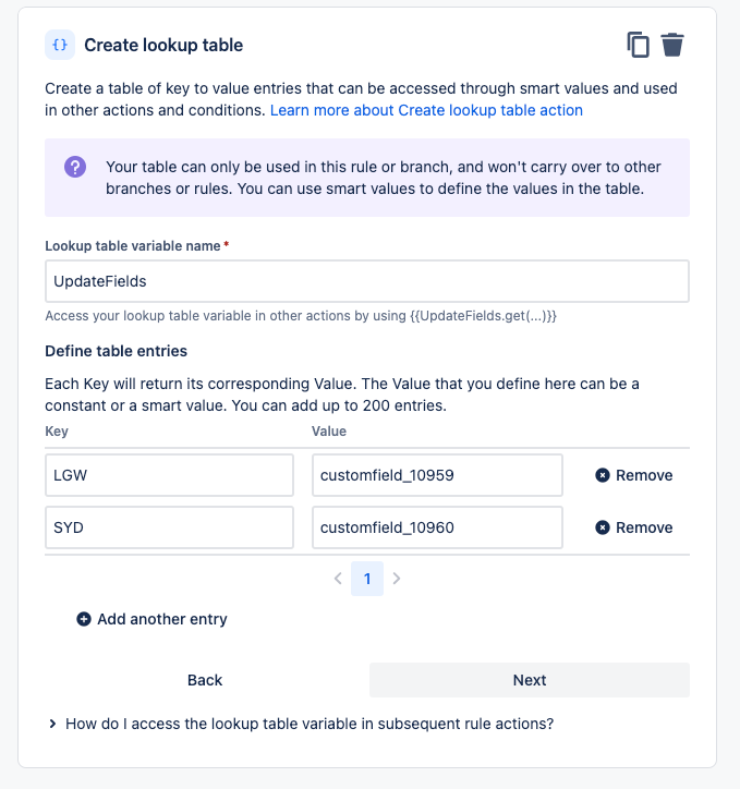

So for the first one I have a lookup table for the custom fields
I then loop through the items in a check box list

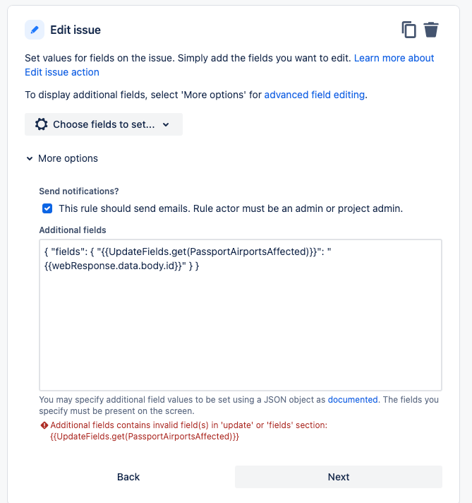

I want to edit the custom field associated with say LGW if has been selected, with the response from the webhook but I get this error. It can't find the smart value.

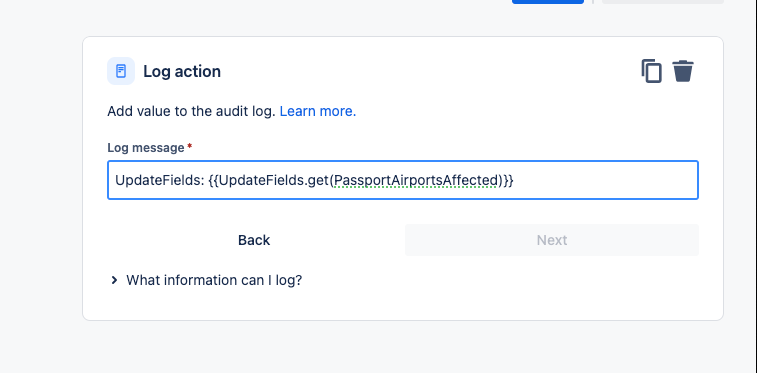

but if I log it the value is correct
If I hardcode customfield_10959 in the edit issue JSON it works.

Have you checked if there are any leading / trailing spaces around the return from the table get() results?  You could add a trim() to confirm that is not the problem.
UPDATED:
I forgot that I had figured out this scenario before  :^)
The rule editor for the JSON edit tries to interpret that expression just-in-time...and so that error is it trying to parse, left-to-right, and so it does not evaluate the smart value for your field name before validating it.
The work-around: create your entire JSON expression in a variable, let's call it varJson, and then use only that in the advanced edit:
{{varJson}}
Like # people like this

Rupert Willis
December 1, 2023
That worked!
Thank you so much Bill. I shall have to remember that little "feature"!
