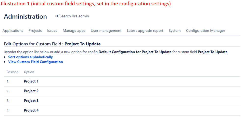

I'm using Jira Data Center v8.20.  I have a custom single select list/drop-down list called “Project To Update”.  In the configuration settings for the field, I configured the field with test options (Illustration 1).

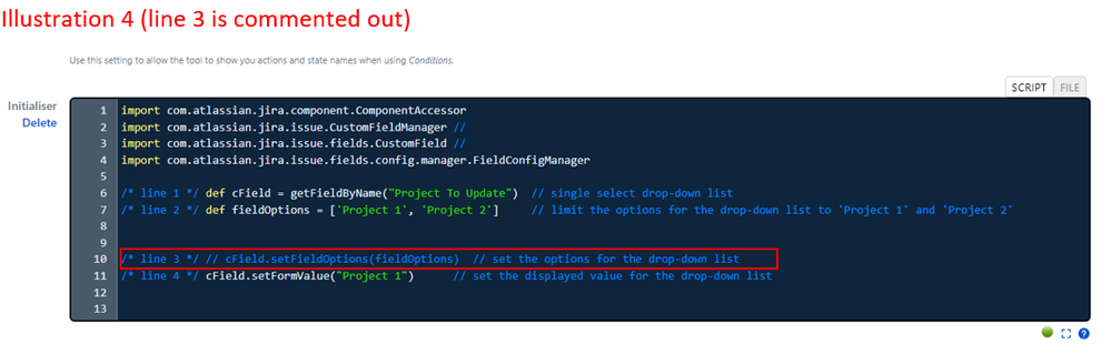

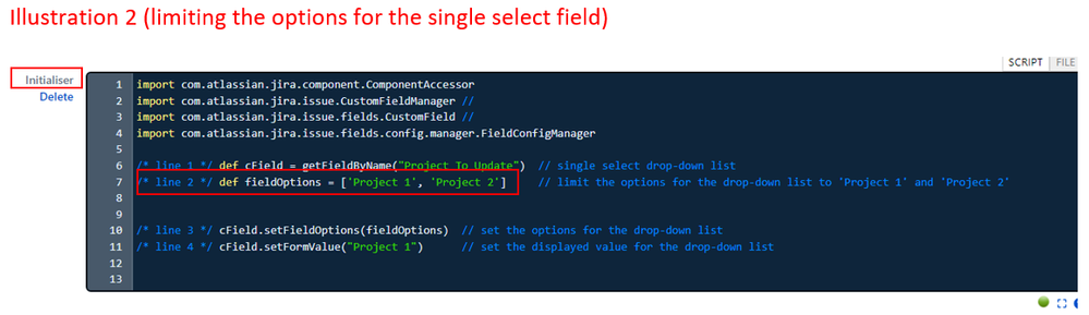

Using behaviours (in the Initialiser section), I’m trying to dynamically set the options available in the select list when opening an issue in Jira (BEFORE the issue is actually created).  Very simple, short code.  For testing, on line 2, I’m just trying to limit the field options for the “Project To Update” field to 2 options (‘Project 1’ and ‘Project 2’).  See Illustration 2.

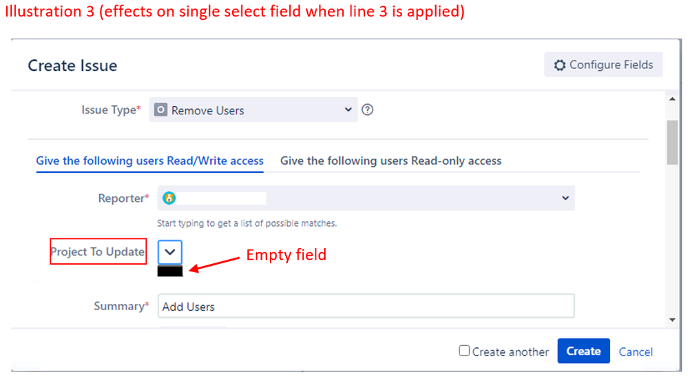

This code (line 3, …setFieldOptions…) is obviously affecting the field, but not as I expected.  The field (Project To Update) is empty.  See Illustration 3.  I'm guessing this may have to do with the way I'm creating the list (line 2), but I don't know how else to set it.

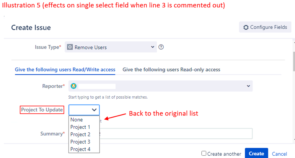

When I comment out line 3 (Illustration 4), the field is populated with the options set in the custom field configuration (Illustration 5).
As stated previously, line 3 is 'getting to' the field, but it's not updating the options list (it's clearing it).  I'd really appreciate a resolution to this.

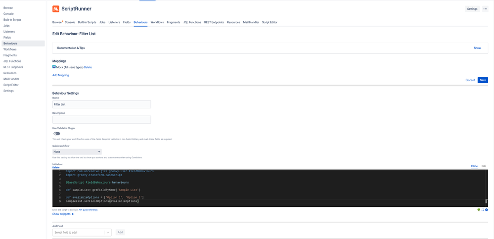

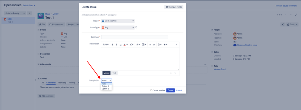

Below is a screenshot of the Behaviour configuration:-
Below are a couple of test screenshots for your reference:-

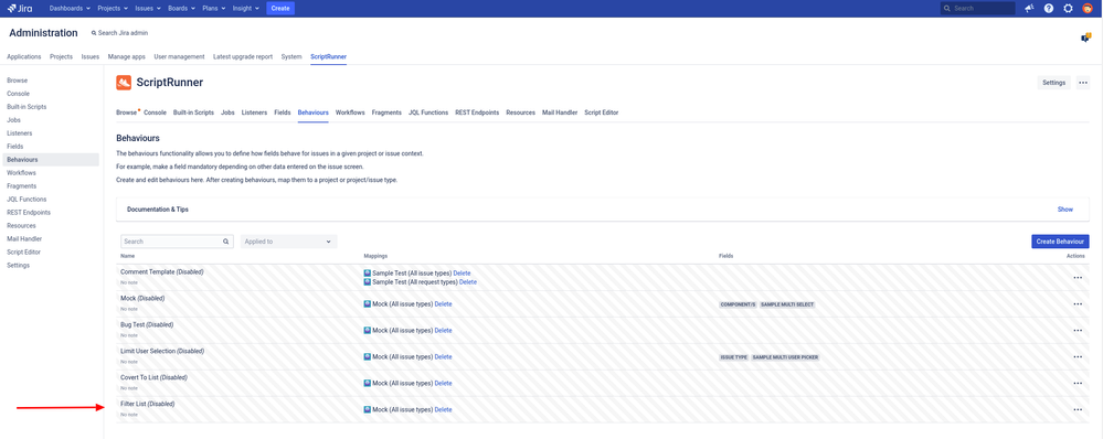

1. Firstly, a test is run when the Behaviour is disabled, as shown in the image below:-

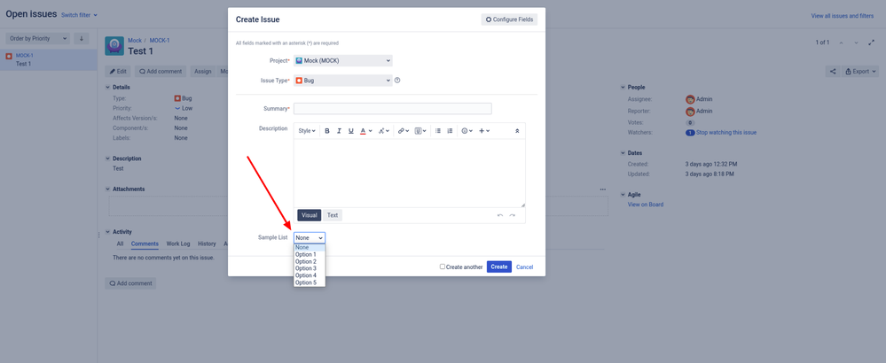

2. As expected, the list is not filtered, and all the options are available as shown below:-

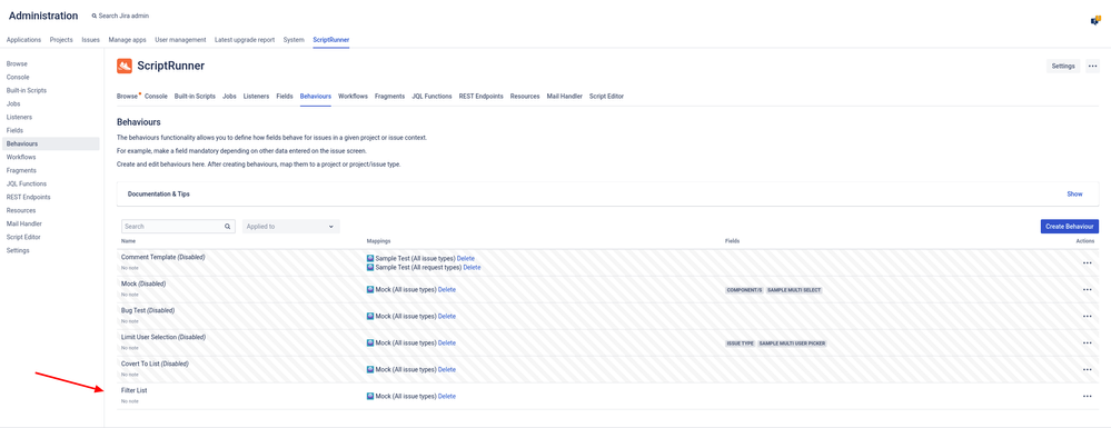

3. Next, the Behaviour is enabled as shown below:-
4. As expected, the List options are also filtered accordingly
