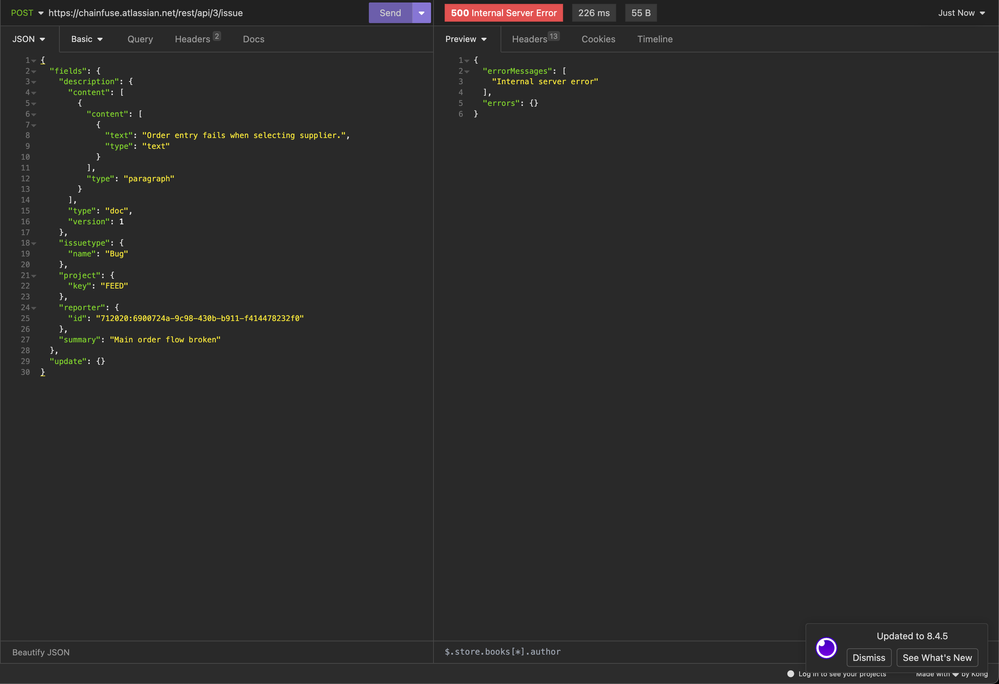

Here's my output, same thing:
I'm using basic auth, putting my email as the username, and the access_token I received after going through the authentication flow I enabled using my Atlassian's OAuth 2.0 App.
Any ideas?
Jeroen Poismans
December 1, 2023
In your screenshot you are missing a closing "}" at the end.

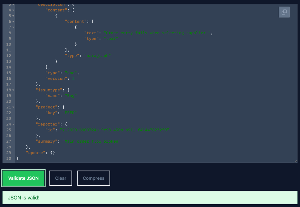

I copy pasted my JSON into a linter and it said the JSON is valid.
I double checked and I have no missing "}". Unfortunately.

I was mislead by the indentation, my bad.

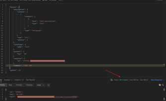

I have done the exact same call (reporter my own id, own project):
The api seems to work perfectly, issues are created so something in the content makes the call fail in your case. One or some of the fields aren't on the create screen of the issuetype in that project, accept and content-type headers ...).
That's about the only thing I can think of because the call works here. Fact that it didn't work in the app, that could have several reasons. Call not working via Postman, then you will have to look at setup again. Try another (test) project?

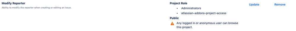

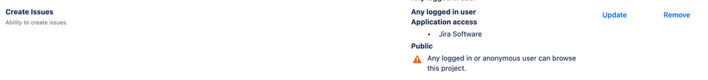

I created a brand new Company-managed project, and now I am setting the permissions.
I am using an access token that I got from oauth with the  following scopes:
read:account read:me write:jira-work
And I have also set the following permissions to public (because I'm not sure how to grant my oauth app these permissions):
These are the only two permissions I've set, and it's still throwing me the same error.

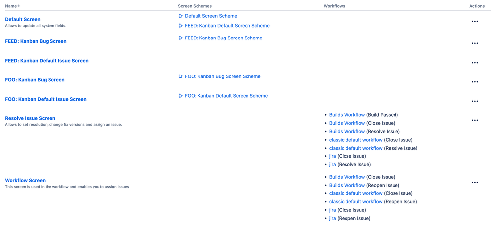

Could it be something in my screens?

The Create screen for the project and issue type should contain all the fields you are trying to set in the call.
