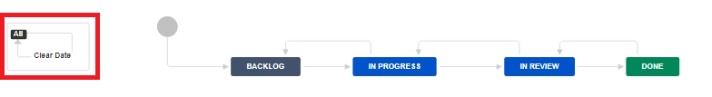

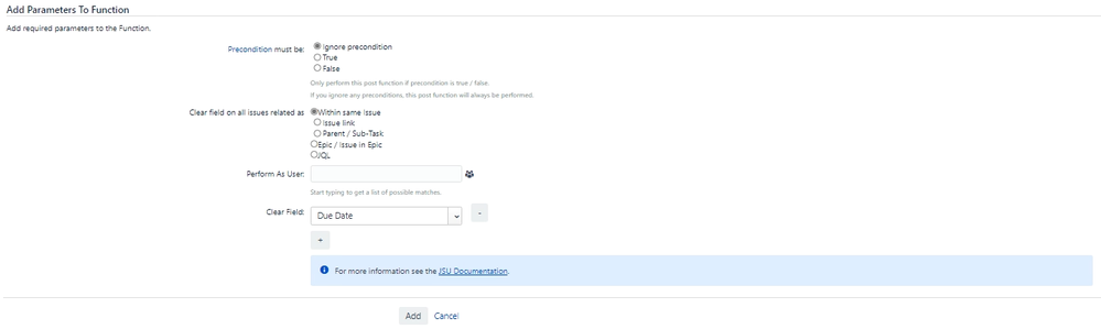

There is an easier way to do it though by using a post-function in the issueType's workflow that goes from all steps to all steps. In the diagram it'll basically just look like it's pointing to itself. This still assumes you have an add-on capable of executing a clear field post function such as Jira Misc. Workflow Extension (JMWE), Jira Suite Utilities (JSU), Scriptrunner, etc.

Thanks.  I ended up doing exactly this last night, transition to itself that ran a post function and cleared resolution which also clears the resolution date.  ran bulk transition update and cleared all the issues I needed.  works like a charm.  crazy it is this convoluted.  thanks for the reply!
