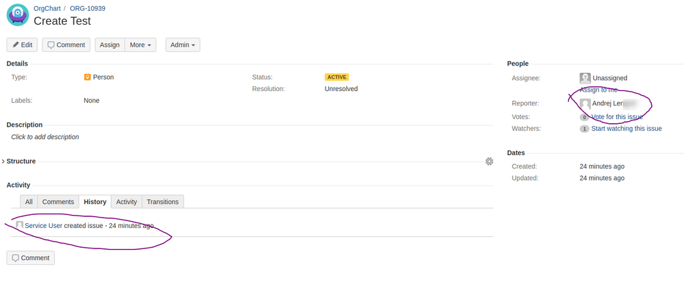

And guess what this script returns:
Joerg
July 22, 2021
Also logging the AppUser variable at any point always returns my personal user, and not the "autoassist" admin user.

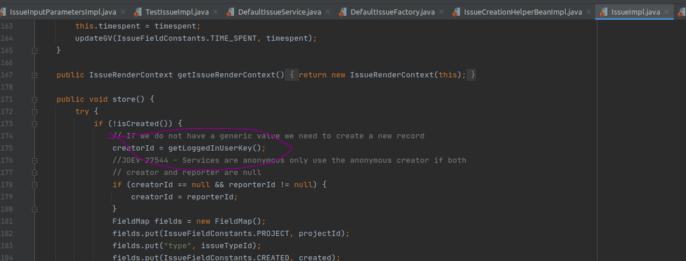

Hi @Joerg , it is interesting. I checked Jira source codes and it looks like setApplyDefaultValuesWhenParameterNotProvided might be the problem.
Short description:
  • if you check com.atlassian.jira.issue.fields.ReporterSystemField implementation, you can see following implementation of method populateDefaults
    • public void populateDefaults(Map<String, Object> fieldValuesHolder, Issue issue) {
      ApplicationUser remoteUser = getDefaultValue(issue);
      if (remoteUser != null)
      fieldValuesHolder.put(getId(), remoteUser.getName());
      public ApplicationUser getDefaultValue(Issue issue) {
      // The default value that should be set if the user cannot modify this field is the remote user's name
      return getAuthenticationContext().getUser();
Can you try to call the method setApplyDefaultValuesWhenParameterNotProvided with false parameter?

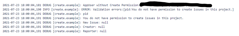

Did some test anyway:
adjusted the script. I removed the create permission in the project from the "appUser". Only the adminUser now has create permission there:

This is in the logs now:
Joerg
July 23, 2021
Only if I set the loggedInUser to the adminUser it works, although I use the adminUser in the create method anyway.

Hi @Joerg sorry for late response, I played with it few evenings and it's working now for me
  1. I removed all the logging functionality so it should be clear now
  2. it looks like the "user" value set as parameter of validateCreate and create methods is not taken into account because store() method in IssueImpl always uses logged in user. If there is no logged in user, reporter is used to be creator:
  3. If I use following code
    1. I'm logged in as service user
    2. I used martin.bayer@external.com user to be used as parameter
    3. I used a.leng@external.com as app user who should be used as reporter
    4. permissions for the project is set:
    5. code is:

    6. and it creates issue with these attributes:
I hope it will help... a little :)

So basically you are confirming that the permissions are run against the loggedInUser then (unless there is none, then reporte is used)?
I wonder what is the point of the parameter in the validate and create methods of IssueService then? Is the user in parameter used to check permissions, but when it comes to storing the issue, there is an additional permission check for the creator (normally LoggedInUser), which has to have the create permission as well?
If so, then I wonder if this is a bug or oversight by Atlassian, because it is definitely confusing.
I guess my workaround would be (if the currently loggedInUser has no permissions, and I need to create the issue with another user) to:
