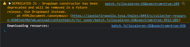

2022-05-18 14_29_39-Essai de soumission de ticket dans TEST_SLO et 4 pages de plus - Travail – Micro.png
Bertrand Delaitre
May 18, 2022
Thanks for your answer.
Nothing about cookies in console. And edge://flags is forbidden by our IT.
