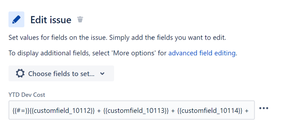

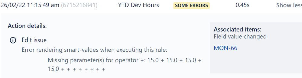

Hello - I've set an automation rule to sum multiple numeric value custom fields. The automation rule worked perfectly when I was adding two fields, but when I included more fields that I wanted to sum, I received the error below.
Here is the script in the Automation section:
{{#=}}{{customfield_10112}} + {{customfield_10113}} + {{customfield_10114}} + {{customfield_10115}} + {{customfield_10116}} + {{customfield_10117}} + {{customfield_10118}} + {{customfield_10120}} + {{customfield_10121}} + {{customfield_10122}} + {{customfield_10123}} + {{customfield_10124}}{{/}}
Looking for guidance here.

Hi @Matthew Pears ,
I could reproduce this behaviour in 3 ways:
  • adding a field that is not configured as numeric field
  • One of the custom fields of the calculation is not associated with the issue type/screen scheme
  • One of the fields in the calculation is empty
Hope this helps and helps solving the problem.

Hi @Stefan Salzl
Thanks for looking into this. I've checked all three items you mentioned, and everything seems to be correct. Still getting this error.

@Stefan Salzl UPDATE
I plugged values in all of the fields I am attempting to sum. This worked. However, I dont want the rule to behave this way, as some of the fields wont have values at the same time.
So, how do I need to modify the code in my original message to reflect this?
Stefan Salzl
February 26, 2022
aaaah.....okay.
Guess the easiest way that comes to my mind would be to set default value '0'.
Would that be a feasible way?
Best
Stefan
Like # people like this
Stefan Salzl
February 26, 2022
Mainly the tough part of automation is to really be sure about the concrete use case/requirement, the specific conditions and specific action regarding use case and conditions. "random behaviour/conditions" is the opposite of automation.
Are there any special cases where it can be specified which of the fields should be filled and therefore summed up?
If this isn´t the case and all fields should always be summed regardless of value or not I would suggest to add the default value 0 as this is a identified as number and can be calculated. Otherwise the field is identified as empty which cannot be calculated.
Hope this helps.
Best
Stefan
Matthew Pears
February 26, 2022
@Stefan Salzl you're awesome. I set the default value to "0" which fixed my problem. The Automation works perfectly.

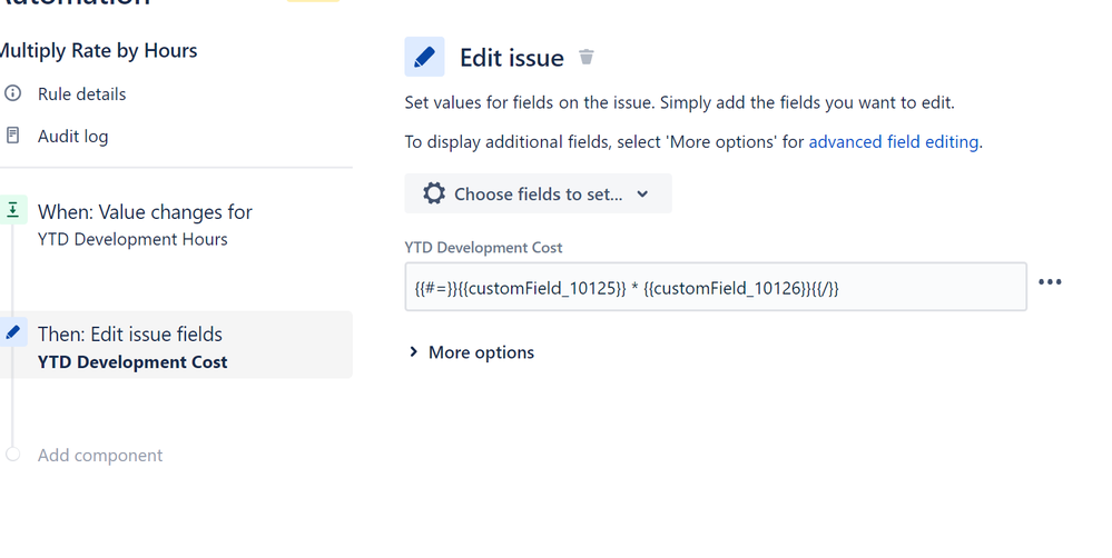

However in trying to add a new rule on the same issue, I am trying to multiply two fields, and now I am seeing some strange behavior. The automation is working, but it is multiplying the last value in the field. For instance:
Initial Value = 0
New Value = 5
New Value = 10
Where I would expect the rule to multiply the fields first new value (5), but it does not. However when I change the fields value to 10, then it finally multiplies by now the old value 5.
I need it to multiply the "newest value" in the field.
{{#=}}{{customField_10125}} * {{customField_10126}}{{/}}

I would need more context here. Could you provide a screenshot of the field and name
  • which field gets updated (that triggers the rule)
  • which fields should then be multiplied and
  • which field should then be updated with the result
BTW: You could also use the name of the field instead of the field_ID in smart values. That makes it easier to read and understand automation rule (especially for me as a reader) 😉

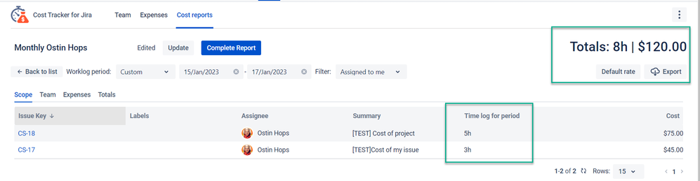

Try to use add-on , developed by my team - Cost Tracker for Jira Cloud .
It multiple People logs to People rates per hour, and you can generate reports with this data. Also, the Cost Tracker for Jira Cloud add-on allows you to track all your company's expenses.
It's free.
Example of report:

I'm Running JSM DC 5.6.0, but on my installation something like this works really well:
{{#=}}{{customfield_10112|0}} + {{customfield_10113|0}} + {{customfield_10114|0}} + {{customfield_10115|0}} + {{customfield_10116|0}} + {{customfield_10117|0}} + {{customfield_10118|0}} + {{customfield_10120|0}} + {{customfield_10121|0}} + {{customfield_10122|0}} + {{customfield_10123|0}} + {{customfield_10124|0}}{{/}}
If you append the "|0" to the end of the custom field identifier, the sum will take the value as zero if the field is NULL. That should get rid of your error!
Definitely make sure all the fields you're summing are numerical fields only though.

Andreas Knecht
March 2, 2022
Please note that you can also use default values for smart-values. See the bottom of https://support.atlassian.com/cloud-automation/docs/jira-smart-values-issues/
Something like this should work: {{customfield_22222|0}} (note the |0 at the end)
