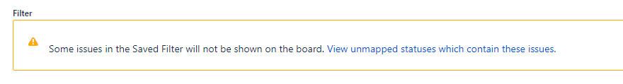

Notice that this comes up when I look at  the configuration of the Board. Could this be the problem?
Ege Su Inan
November 29, 2018
This shouldn't been a problem but sure there is no harm to fix this one as well, map the statuses with your board statuses.
