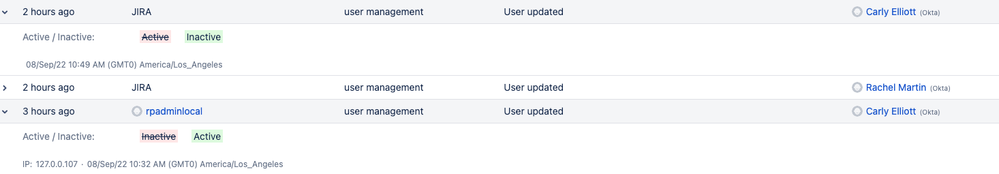

Hello, We started noticing more users accounts are showing "inactive". The users are still with the company and have not been removed from the systems. I went in and switched one user back to active. Then shortly after jira switched it back to inactive. We have Okta and no LDAP/AD for user management. I am new to Jira and need some help with this please. Checked the forums but doesn't seem to be a fix for this scenario.
@ Martin Bayer all it shows there is I went in and activated the user. Then manually ran the sync and then Jira set the user to inactive.

It looks like Okta is doing the provisioning via API. I just created a new API token in Okta and entered it in the existing connector in Jira under the User Sync configuration. But that seems to not have fixed the issue. I found a band aide for the issue. By changed the cleanup behavior setting from disable accounts to Do nothing. So I am not sure whats causing this if the users account in Okta are active
Hi @jason.heaney can you check audit log? It might give you more details about deactivating user
https://confluence.atlassian.com/adminjiraserver/auditing-in-jira-938847740.html
Good question.. How do I check that? Sorry, I am very new to Jira.

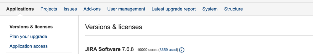

I checked under Applications->versions and licenses and no banner is there saying we are exceeding the user licenses.
@Martin Bayer _MoroSystems_ s_r_o__ Is that where I check if we are exceeding our user tier? Or is there another place?
Please advise. Thank you
HI @jason.heaney , I'm just checking on Jira 7 and it looks like:
So I can see what is the consumption of the licences...
Hello @Martin Bayer _MoroSystems_ s_r_o__
That is where I looked and it shows unlimited users (397 used). I don't think this could be the issue then, right?
