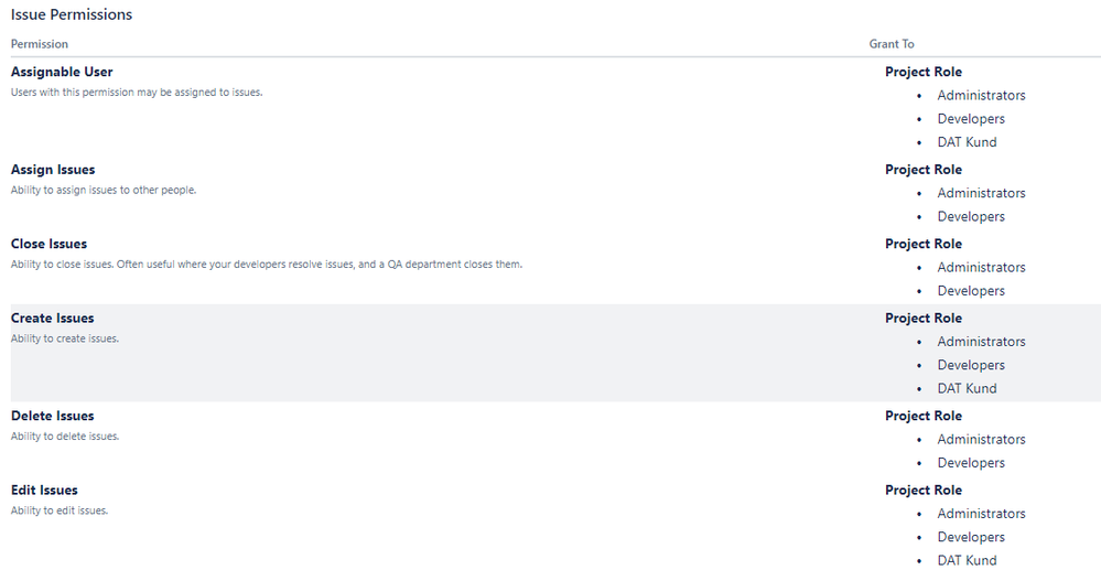

I'm in the need to create a role in my project for users that only should be able to create and edit Bugs. The can read everything else but should not be able to create or edit other issue types or do anything else in the project.
It will be used for internal customers that we deliver to so they can report bugs after releases and the reason why I don't want them to have any more permissions is that I don't want them poking around in the project and making a mess 😊
Right now I've added a role and set up a Permission Scheme for my project but there you can only set it up for all issue types and not a specific one. The role is called DAT Kund (swedish)
Any ideas on if and how I can solve this?

with Standard Jira this isn't possible. Permissions can only be based on projects but not on Issue Types within.
You can achieve that with ScriptRunner behaviours though: Restricting Issue Types with ScriptRunner for Jira (adaptavist.com)

You can use issue security scheme to hide the other issuetype tickets to your internal customer.
Link how to create security level: https://support.atlassian.com/jira-service-management-cloud/docs/create-security-levels-for-issues/

Issue Level Security only works once the issue is created and doesn't stop anyone from creating an issue regardless the type.
