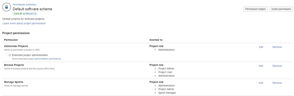

I am facing a strange issue with my permission scheme, users are not able to create or start sprints.
My environment - Jira v7.4.2
Project Roles - Administrators, Project Admin, Project Users, Sprint Manager
Permission scheme;

Ok, so your manage sprints rights have project admin, administrator and sprint manager.

I did the exact same procedure as you suggested, but the issue here is when I define a new Project Role or use the existing role to the permission scheme, it is still not allowing the users under that role to manage the sprint boards.
And when I add the users to a group and give that group Manage Sprints permission globally, then it is allowing the users to create or start sprints.
The below configuration works for me, but I do not want to do it this way. Can you tell me if I am doing anything wrong here?

When I check with the permission helper, it says that the user belongs to project admin, manage sprints roles and has the manage sprints permission.
But the users see the boards with grayed out option to create sprint.
