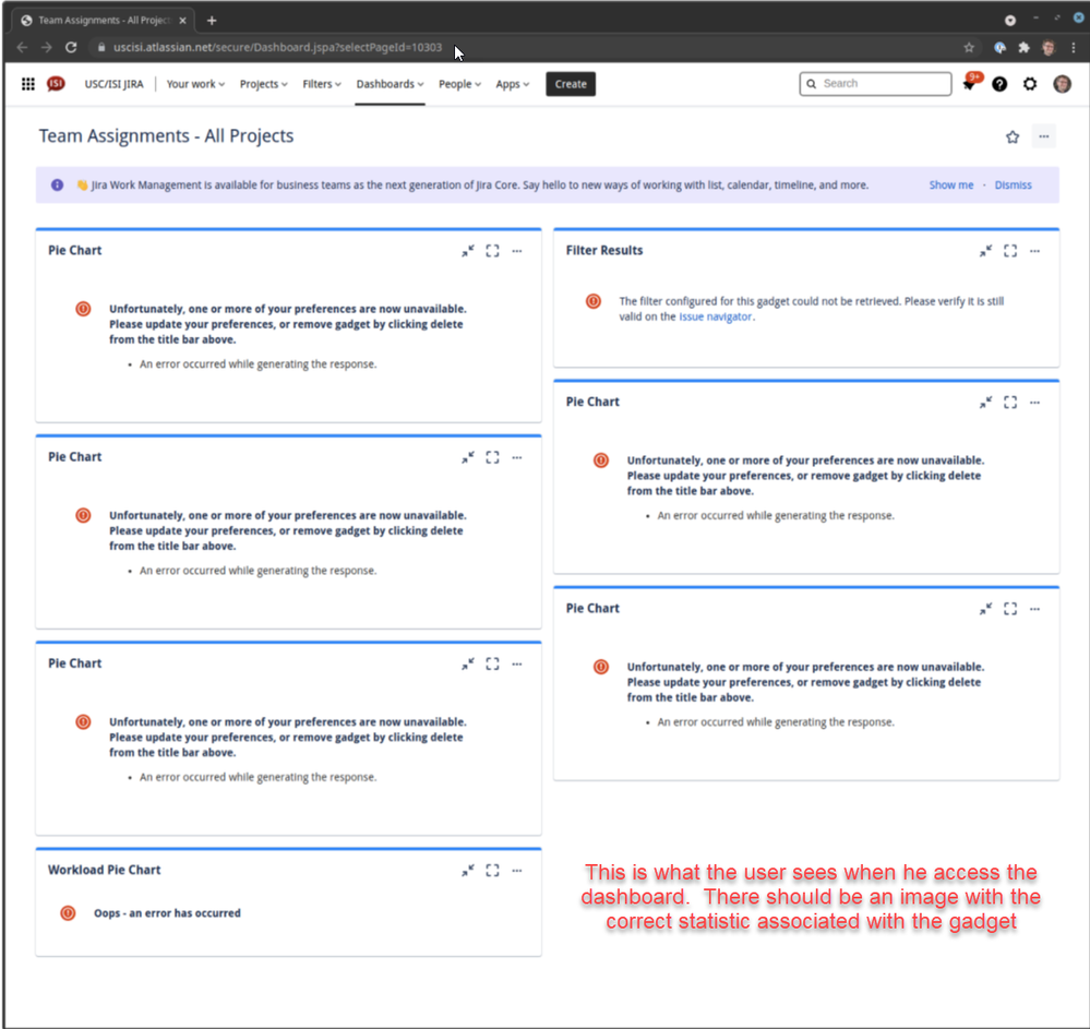

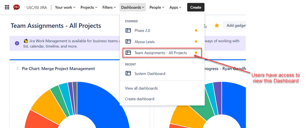

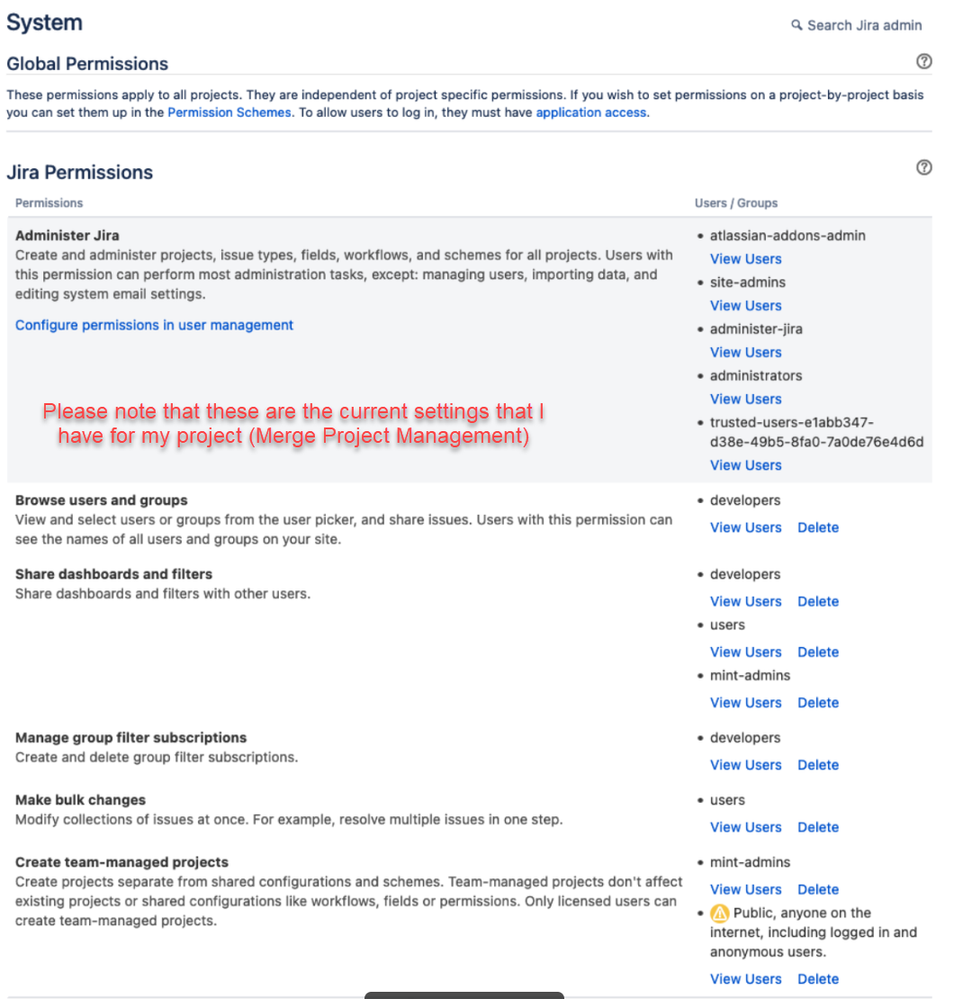

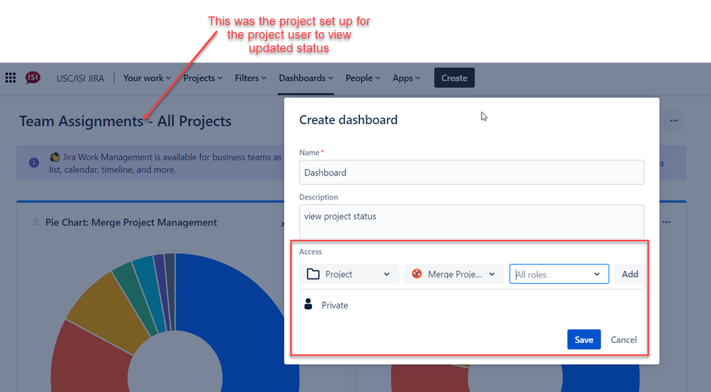

Please advise why the users on my project get an error when viewing the Dashboards that I have created.  Please see the screenshots below for the details. . . .
NOTE: There are 4 screenshots included in this document

This issue usually happens when there are permissions issues on the project or with the filters used on the gadgets.
The third screenshot shows the Global permissions, so please, go to Project settings > Permissions and check if all the roles of the project have “Browse project” permissions.
Testing here, I was able to confirm that the error they are seeing happens when the filter is not shared with them.

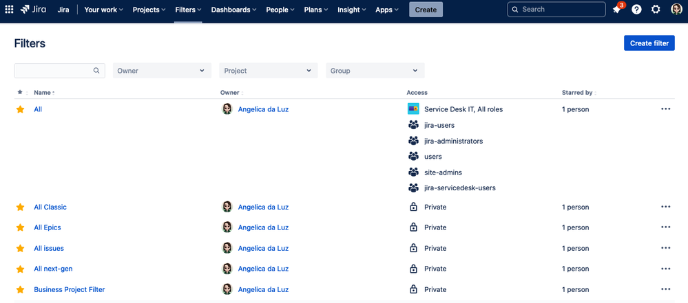

Please, go to Filters > View all filters and confirm if the filters used on the gadgets are shared with the users as well.

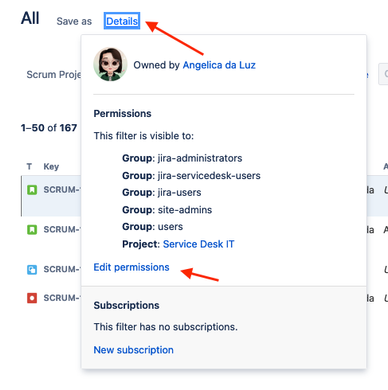

If not, click on the filter’s name > Details > Edit permissions.

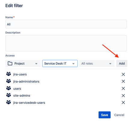

Note that, it’s necessary to click on Add and then Save.
Here is a simple gif showing the steps: https://share.getcloudapp.com/04u25lXL
Please, give it a try and let us know how it goes.
