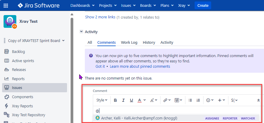

The User with Administrator and User roles can use the User Mention feature.

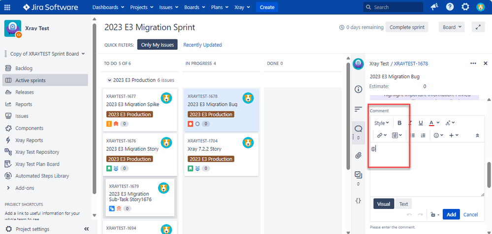

The Users with Administrator role are not able to use the User Mention feature when the issue is open on the board. They can only enter User Mention when they open the issue in edit mode. I added the user role so they mirror the user that can do the User Mention from the board and still not change. Any other thoughts on troubleshooting, or is this a known issue?

@Kelli Archer is the @mention issue only happening on the board or is it happening on the project associated with the board?
Only on the board, so the workaround is to open the issue and use the @mention from there.
Can you share a screenshot. I am trying to recreate.
