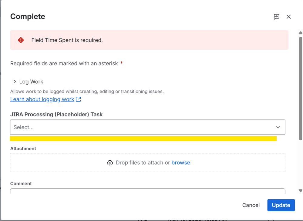

User has to expand Log Work on transition screen - different than the rest of the business
Kristin Rains
June 2, 2026
I have a user that on the transition screens she has to expand Log Work to enter her time. image-20260529-200451.png

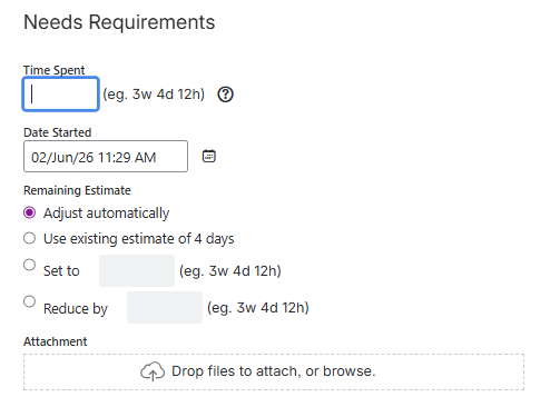

This is new for her and different from what other users are seeing in our instance. This is how it looks for me

I have no idea why her's is different or how to change it back to the normal view.

thanks for the reply! I saw the same ticket and same experience. No one on our side can figure out where the setting is that can be turned on or off.

Hi @Kristin Rains,
since you have the desired view: Do you have the toggle option in your settings?
It is 'General settings' in 'Personal Jira settings'.
If not, then it is probably an issue with obsolete data from your browser's cache. The browser of the user with the collapsed view simply executes the latest data coming from the servers.
You could verify this by doing a full reload of the page, bypassing your cache.
