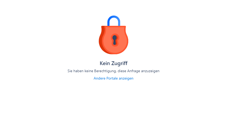

After the user creates a ticket in the user portal, the following page appears
that means:
"no access
you have no right to see this issue
show other portals"
though when I go as admin into the administration portal, I´m able to see that the ticket was created.
What could be the problem?

When I checked the permissions, I saw that the user doesnt have any rights.
But when I checked other projects, I saw that other customer´s users also have no rights on this project but they were able to see/work with tickets and didnt have the issue according to the screenshot above.

Maybe I need to put a finer point on it. What I mean with user is actually our customer who is using the customer service desk (customer portal) and who is creating there its own tickets when he/she has a problem or needs support.
Those created tickets can be any support question regarding the problem (e.g. Outlook issue, printer/scanner issue, telephone/Word/Excel issue and so on.
And the current problem I mentioned very very above by showing the screenshot, is only occurring in that project. Even though I´ve checked all settings and compared it with other project, me and my team couldnt see any difference. We checked the rights, permissions, security schemes --> nothing its all set similar with other project.
Customer A,B,C,D,E from Project 1 can create ticket and is able to view his/her created ticket, add comments, files, anything. No problem at all
Customer A,B,C,D,E from Project 2 can create ticket as well but is not able to view it afterwards. The customer gets this message/report on the next page:
This report says:
"no access
show other portals"
What I dont understand is that the customers A,B,C from project 2 have the same permissions as the customers A,B,C from project 1 but somehow all customers from project 2 cant view their tickets.
So what else can I check and hopefully solve this problem with your help?

We´ve doubled checked all settings again and decided to just try to copy the permission scheme from another project. (even though they all have the same schemes) but just to give it a try we have copied and pasted it again. --> somehow it worked for the user.
Maybe it was a tiny bug.
Thank you for your help!
