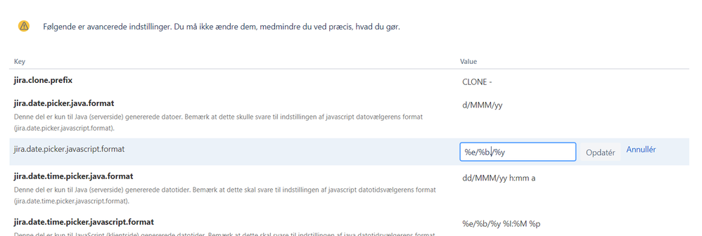

In the advanced settings I was able to find this field jira.date.picker.javascript.format, which dictates the format in the client. By adding the dot after month, as shown below:
I tested by creating an issue from my own account and also from another user from the portal - both worked out, without complains.

July 29, 2020
You found the solution! Fantastic! Now she can actually create tasks with deadlines.
Thanks Magnus.

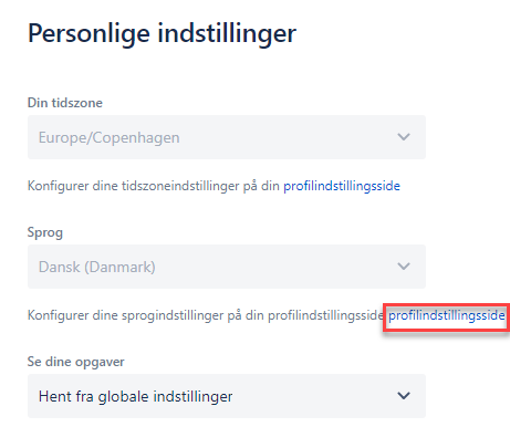

I made the changes and it seems to work for her. But the change did that other accounts could not create delivery date. I found that the language was set to Danish under Personal settings. If i the clicked on the 'Profile settings' 2020-07-31_13-33-17.png
The language was set to 'English (US)'. Therefore there was a need for '.' as you mentioned, but if it has danish settings it must be set to Danish.

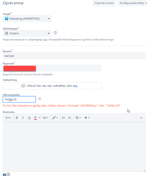

Hi again,
I have now attached an screenshot of the issue. This is when she 'create' a new issue. As you can see it presents the wrong format, even though it is correctly setted up (what I know of).

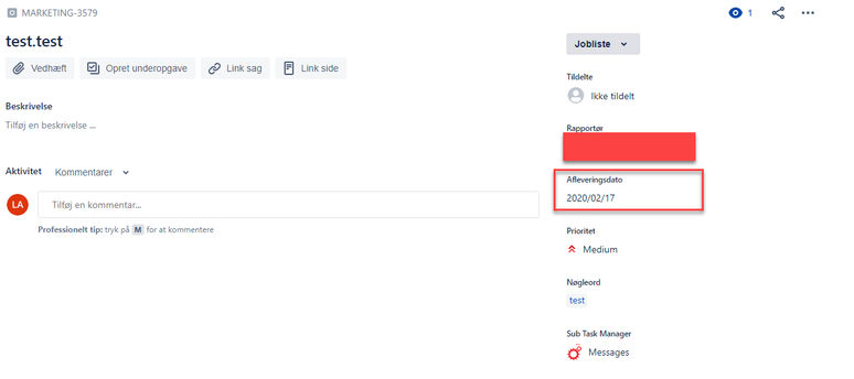

If she creates the issue, and the afterwards clicks on the due date (Afleveringsdato), she now can insert the correct date.
Snag_2f9d1a76.pngAny other users in the same project, do not have a similar issue.

Thanks Simon.
Unfortunately I don't know what could be happening, but I see that she is using jira's new look and feel, and I personally experienced several mistakes using it; so, even if it's just to verify, if you want you can try switching it off and see if it continues to happen or not.
You can switch it of from Personal Settings.
