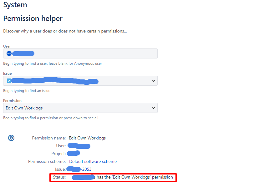

User has the permission to edit own work log in the permission scheme. But edit option is not available in the issue view under the work log section.
Edit option disappeared after Restoring the data from xml backup.
Can anyone help me with this?

2 - During the XML restore, a new user was created for him instead of using the same user that created the worklog entries previously:
It is possible that a new user has been created after the backup restore, causing the previous work log entries to be related to a different user which he is not able to edit. The easiest way to confirm if that's the case would be by temporarily add the user with the "Edit All Worklogs" permission and check if he is able to edit the mentioned work logs.

Thank you very much Mr. @Petter Gonçalves for the response.
The second option worked for me !!
