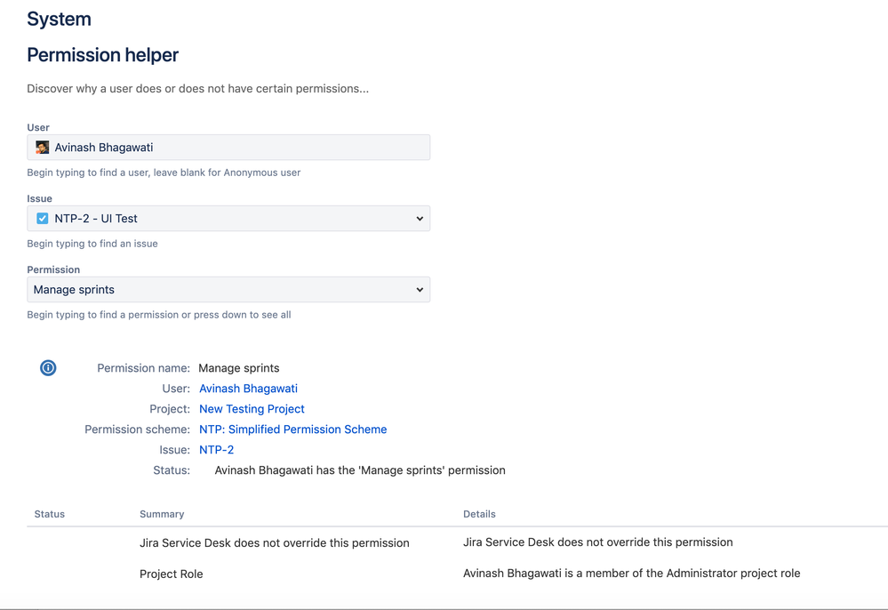

Avinash Bhagawati _Appfire_
November 4, 2019
Hi @Rohan Nishantha ,
Revert back filter same to Rank and confirm whether you have included any other project ( to which user may do not have access) issues in filter board. Also check permission for user with issue for manage sprints.
please replace your jira url in below.
https://your jira url/secure/admin/PermissionHelperAdmin.jspa
Thanks,
Avinash
