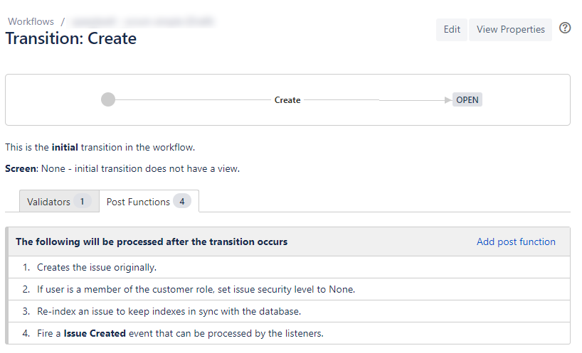

In an attempt to workaround this I've tried using workflow to set the level, but it doesn't work:
I have found that if I move the line to set the issue security to the first line of the post functions it will work. Though this means workflows need to be paired with issue security schemes.

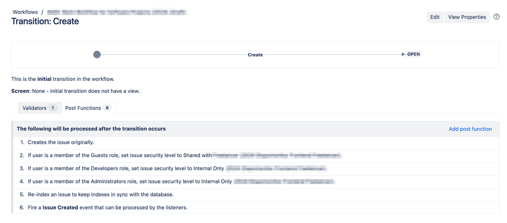

Would take too long to explain the many ways I tried. But here's the crux: We need multiple post-functions in the Create transition to achieve this.
Our setup:
