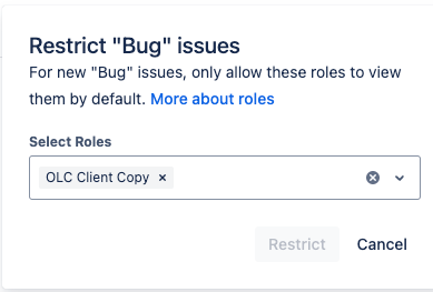

I've attempted to set a role with limit to only see BUG tickets.
I asked this user to log out and back in - and provided him with a link to the Board.
He is still seeing other types of tickets.
Am I doing something wrong?

What you have done is restricted the Bug type issues to be visible only to people in the OLC Client Copy role.
That affects only who sees the Bug issues. It has no affect on the other issues.
To prevent the users from seeing the other issues types, you have to restrict those other issue types to Roles in which the user is not a member.
By default all issues types are visible to all roles - when no restrictions are set.
You add restrictions to limit who can see the issue type.
For the issue type the clients can see, if you want the clients plus all other project members to see those issues, then don't set any restrictions on that issue type.
Then you need to define role(s) that encompass all the members of your project except the clients.
Set restrictions on all the other issue types the clients should not be able to see. Add all the role(s) that do not include clients. That will make those issue types visible only to the people in the specific roles. If the clients are not in those roles, they can't see those issue types.

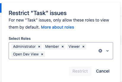

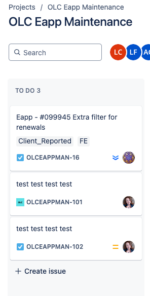

I modified the restrictions on "Task" and does not include "OLC CLIENT" role.

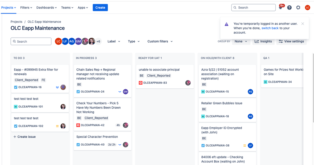

I have a user with role "OLC CLIENT" only.
I created a new TASK --
I impersonated this user via Admin Controls.
But I am still seeing the newly created TASK when I view the board as this user.
Last one in the column on left.
Am I still doing something wrong?

Were those tasks created after you set the restriction on the Task issue type, or before?

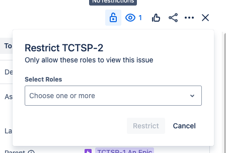

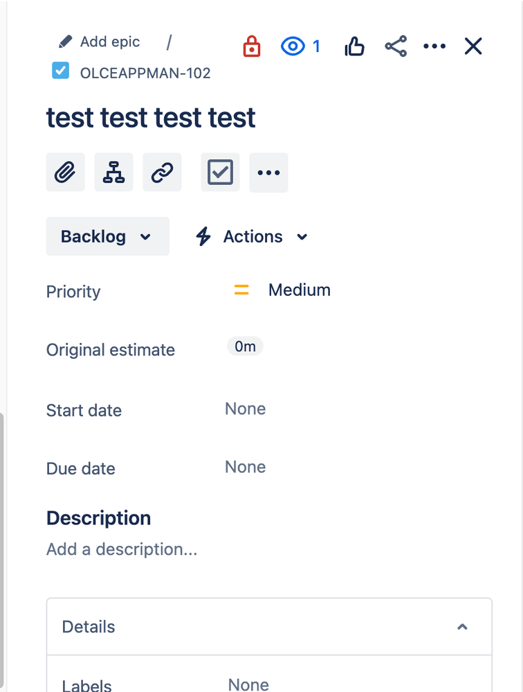

If you open one of those Tasks, does the Restrictions icon (the padlock) show unlocked or locked?
Setting a restriction on an issue type will affect only issues created after that. Pre-existing issues remain unrestricted. You have to manually edit each of the pre-existing issues of that issue type to set the restrictions on it.

@Trudy P Claspill
It shows locked.
Trudy P Claspill
August 18, 2024
Can you show us the user icon for the logged in user on that tab with locked issue, to confirm it is LC for the user who should not be able to see the issue?
If the padlock icon is clicked by that user in that view, what do they see?

@Trudy P Claspill  Thank you for your help with this.  Below is screen shots.  The last 'task' in the left column was created after changing his role - so would expect not to see it. Screenshot 2024-08-19 at 7.23.54 AM.pngScreenshot 2024-08-19 at 7.24.20 AM.png

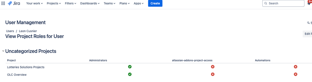

Here's his user profile - in case it is helpful:

Would his 'admin' check marks be throwing off the view?
Trudy P Claspill
August 19, 2024
Indeed it could be.

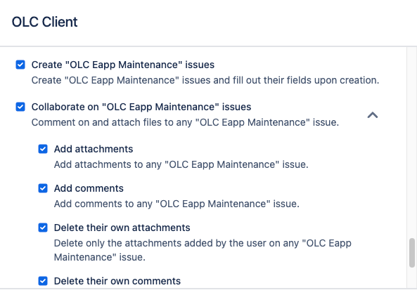

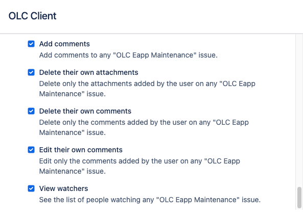

Screenshot 2024-08-19 at 3.25.21 PM.pngScreenshot 2024-08-19 at 3.25.15 PM.pngScreenshot 2024-08-19 at 3.25.07 PM.pngScreenshot 2024-08-19 at 3.25.00 PM.png

Sorry for my "typo" in my last message. I should've been saying the OLC Client role but instead typed OLC Overview role.
In the screen where you see the user has Administrator role, that is specific to the OLC Overview and Lotteries Solution projects. That should not have any impact to the OLC Eapp Maintenance project. Also that page will show you only their role associations in Company Managed projects. It does not show role associations for Team Managed projects.

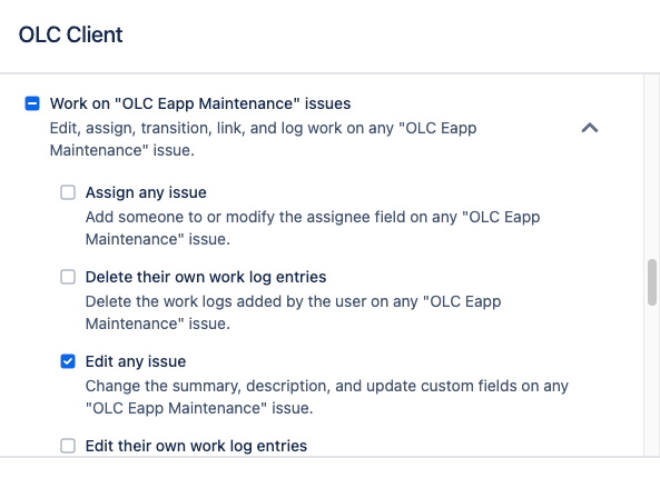

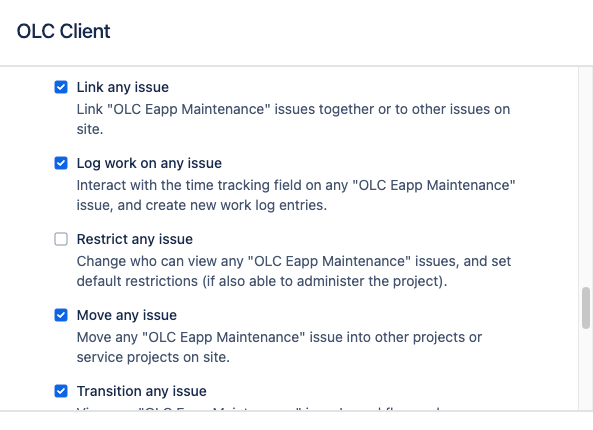

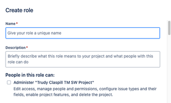

Does the OLC Client role in the OLC Eapp Maintenance project have the Administer Project permission?
If the user is assigned to a role that does have that permission in that project then they will be able to see all issues in that project. You would need to revoke that permission from the OLC Client role

The OLC Client role does NOT have Administrator rights.
The test user (Leon) is assigned to that role in this project, and does NOT have Administrator rights -----HOWEVER, he was previously an administrator on this project (I changed his role for purposes of testing).  But currently he only has the one role - OLC Client - with no admin rights.
