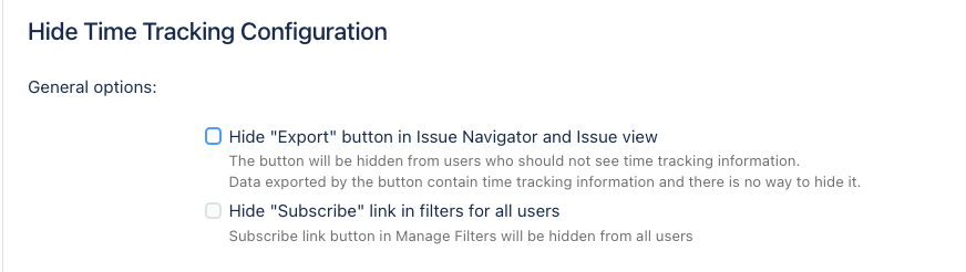

Normann P. Nielsen (Netic)
January 6, 2022
Despite of (?):
That is our config, - and the Button vanishes on the Filer page on load
Like Christian likes this
Jack Adams
January 6, 2022
We have ours hidden now so the top box there is ticked, but when a user needs an export we literally just untick it and it works again for them instantly.
Not too sure why yours is disappearing still after that.
January 6, 2022
Ok, thanks.
I tried to disable the Addon, and the Export button still disapears after load....
