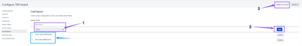

Please follow the steps below to configure the card layout for your Kanban board.
  2. Click on the drop-down list of the Field Name or start typing Start in the search box in order to look for the Start Date (WBSGantt) field and then select the Start Date (WBSGantt) field > Click Add > Click Back to board

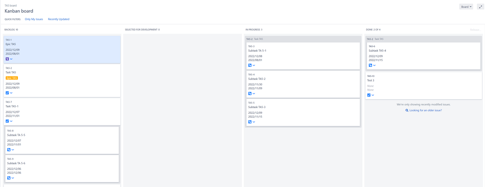

    Note: Repeat the same steps for the Finish Date (WBSGantt) field Card Layout 2.png
I hope this helps to answer your question.

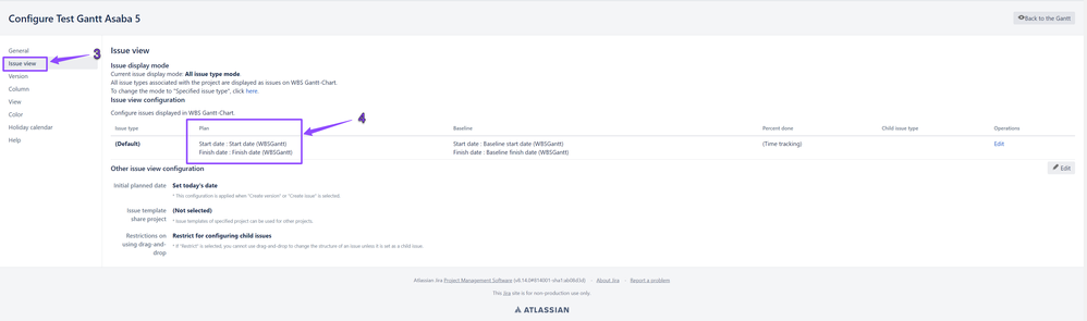

The version I am running is 8.14.0.
You will need to verify the name of the Start and Finish date fields you are currently using.
Please follow the steps below.
  1. Click on the gear icon (Gantt configuration) > Select Gantt configuration Gantt Configuration 7.png
  2. Click Issue view > Verify the name of the Start and Finish date fields you are currently using Gantt Configuration 8.png
  3. Follow the aforementioned steps for Kanban board configurations
    Note: Please ensure that you look for the name of the Start and Finish date fields that you have verified in your Gantt configuration.
I hope this helps to address your concerns.
