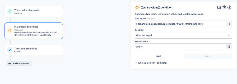

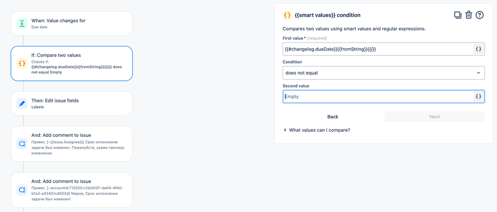

I made a new automation rule and set up a trigger that checks the fullness of the "DueDate" field and, depending on the presence of a value inside the field, makes a label in the task. The example in picture 1.
pict. 1

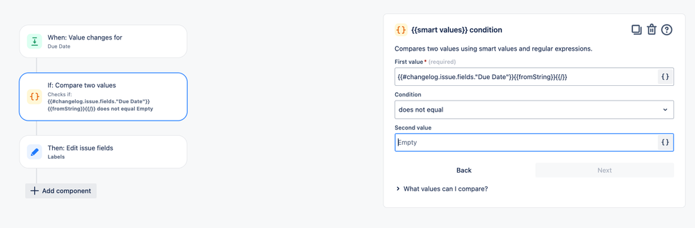

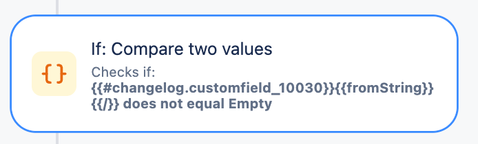

I've tried to make similar designs, but it don't work. Picture 2 and picture 3
pict.2

pict.3

Bill Sheboy
August 1, 2024
Hi @Igor Titov
Smart values are name, spacing, and case-sensitive.  When an incorrect smart value is used, it evaluates to null.
The smart value for the built-in "Due Date" field is {{issue.duedate}} although there appear to be several aliases for it in Jira Cloud.
Please change to use this:
{{#changelog.duedate}}{{fromString}}{{/}}
To confirm the correct smart value (or custom field id) for a field, and if it is supported by automation rues, please use this how-to article: https://support.atlassian.com/cloud-automation/docs/find-the-smart-value-for-a-field/

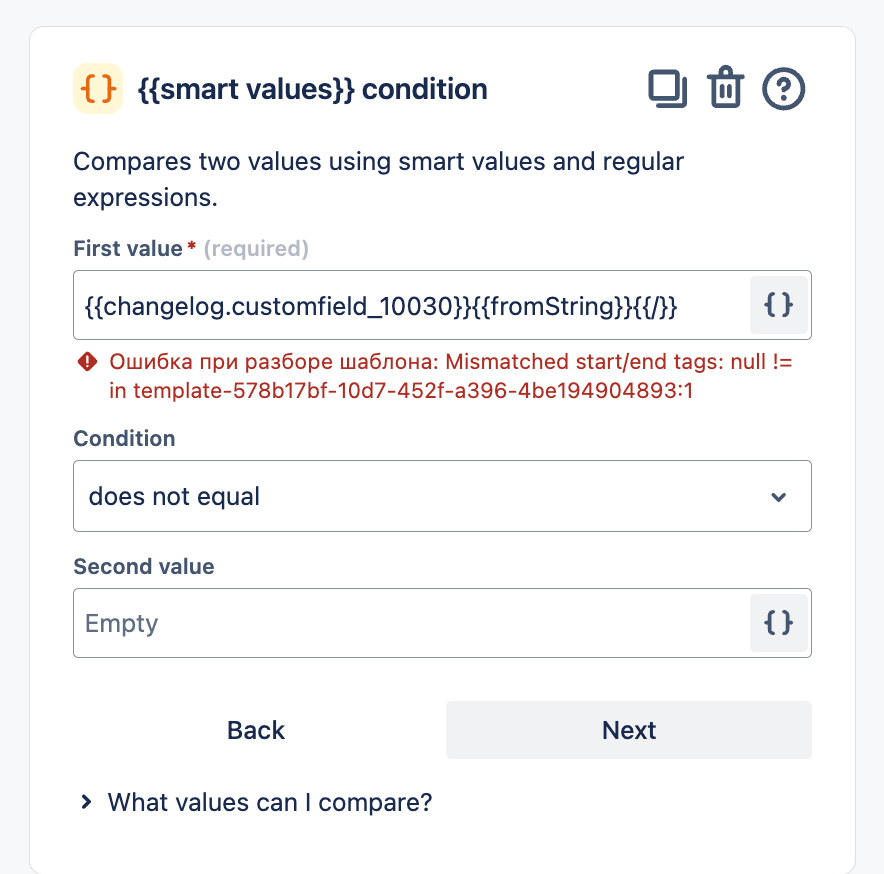

Igor Titov
August 7, 2024
Hi! Ive tried to use ID, but got the error of template

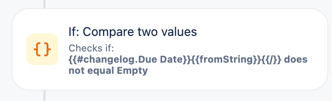

The smart value changelog want to use the name of the field which in your case would be: {{changelog.Due Date}}
It might be conflicting due to the fact the custom field with id 10030 has the same name as the ootb field.
Could you rename the field an test if it will work?

Bill Sheboy
August 8, 2024
Please note your expression is missing the # before changelog, and so it does not evaluate correctly.

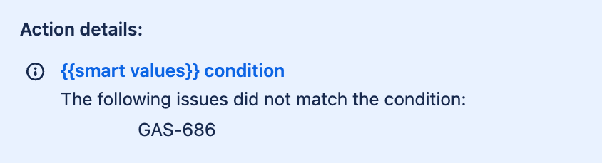

Yep
The error is missing now
but nothing happened

Igor Titov
August 8, 2024
Ohmy! its working!
