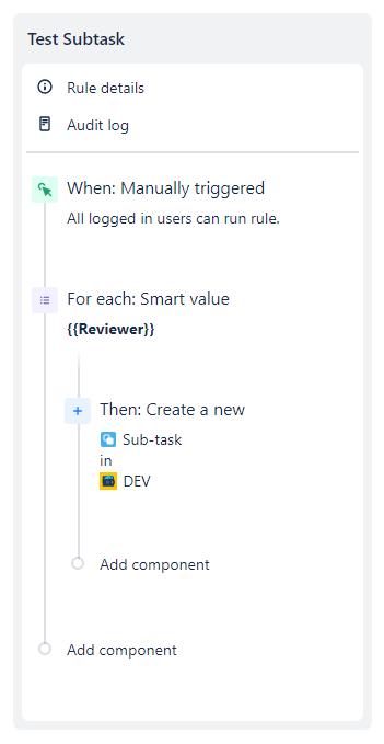

I am having a really hard time figuring out how to write a condition that will check if there is already a sub-task that is assigned to a user.
I can trigger the rule, and create a sub-task and assign for each user from the custom field. When I add a new user to that field and rerun the rule, I am not able to write it where it will only create a new sub-task for that individual user.
Here is the current basic rule, without the condition:Screenshot 2023-11-15 160643.png

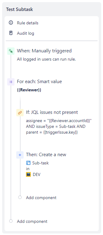

Bill Sheboy
November 15, 2023
Well done; you almost have the whole rule completed.
Please try adding a Related Issues condition for that test, inside the branch and before the action to create the sub-task.  The idea is to check if there are no assigned sub-tasks for your {{Reviewer}} before proceeding.
The specifics to try are:
  • Related issues: JQL issues
  • Related issues JQL: assignee = "{{Reviewer.accountId}}" AND issueType = Sub-task AND parent = {{triggerIssue.key}}
  • Condition: Are not present
The JQL is the key part, ensuring there are no sub-tasks under the trigger issue story...which are assigned to one of the Reviewers the rule loops over.
Brandon Fritcher
November 16, 2023
Yes! This is it. My JQL syntax was just a bit off, but this worked.
Thank you, Bill!
Posting for others to see:
