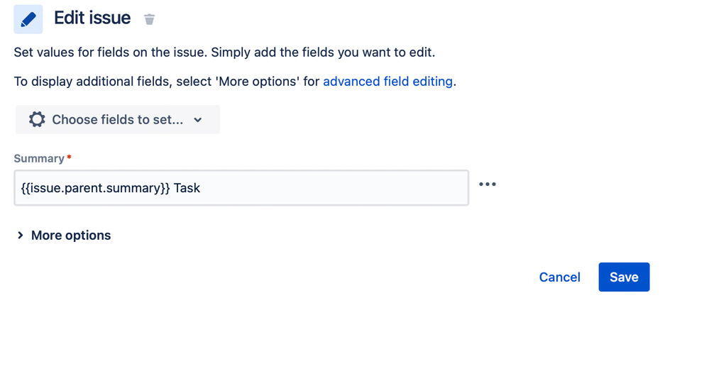

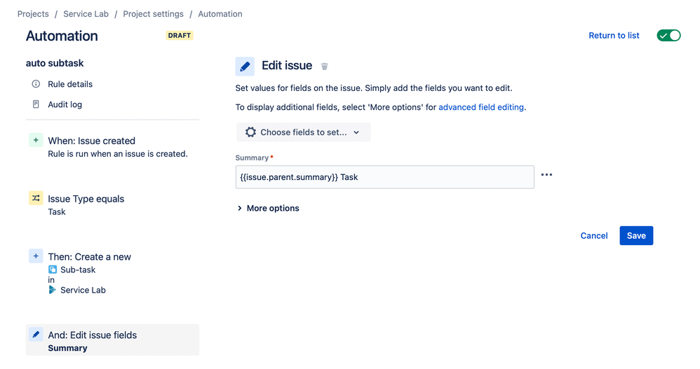

Hi,
I've got a rule for creating subtasks automatically when creating a task that works very well but I want the name of the parent task be part of the summary of the subtask as well so that I can see to which parent task a subtask belongs to.
I tried several smart values but none of them worked.
This was the last one I tried:
Does anybody know what I have to change within the smart values?

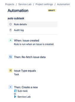

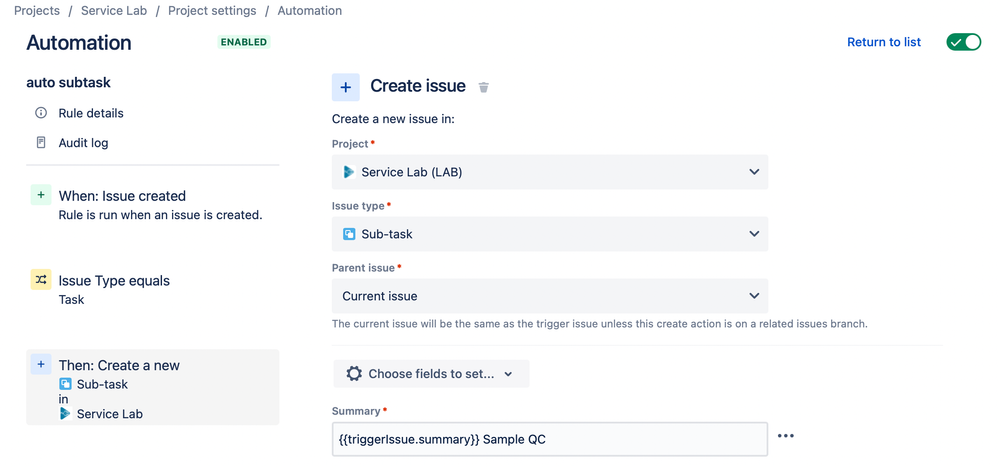

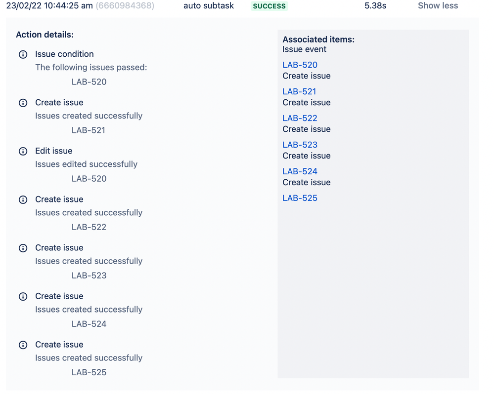

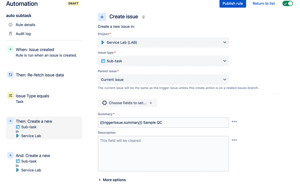

That is curious...just to confirm the conditions, would please post images of:
  • your current rule that does not work as expected,
  • the rule details section showing the settings, and
  • the audit log details for the execution?
And, are you using Jira Cloud or Jira Server/Data Center version?
Thanks!
Pauline Hild
February 25, 2022
I'm using Jira Cloud.
Note 1: The first screenshot doesn't show the hole rule but there are only more "Then: Create a new Sub-task" components so nothing different
Note 2: I already tried to add the "Re-fetch" in several positions but none of them worked
Bildschirmfoto 2022-02-25 um 09.03.33.pngBildschirmfoto 2022-02-25 um 09.04.19.pngBildschirmfoto 2022-02-25 um 09.08.20.png

There appears to be an edit of the trigger issue (e.g. LAB-520) happening.  What is being changed?
You audit log apparently shows adding 5 subtasks.  What value is ending up in the Summary field for those issues created by the rule?

Radek Dostál
February 23, 2022
Can you show us the whole automation rule setup so we can see how you have set it up? That way we can better know if the smart value here makes sense. Syntax-wise it seems fine so, curious what the rest of the setup is.
Pauline Hild
February 23, 2022
Yes, for sure. Here's a screenshot.

Radek Dostál
February 23, 2022
Ah see, the trigger issue is the parent, "Then: Create a new issue" and "Then: Edit issue" - those are 2 separate actions, and it is trying to modify the trigger issue - not the subtask. So because the trigger issue cannot have a parent, the action does nothing.

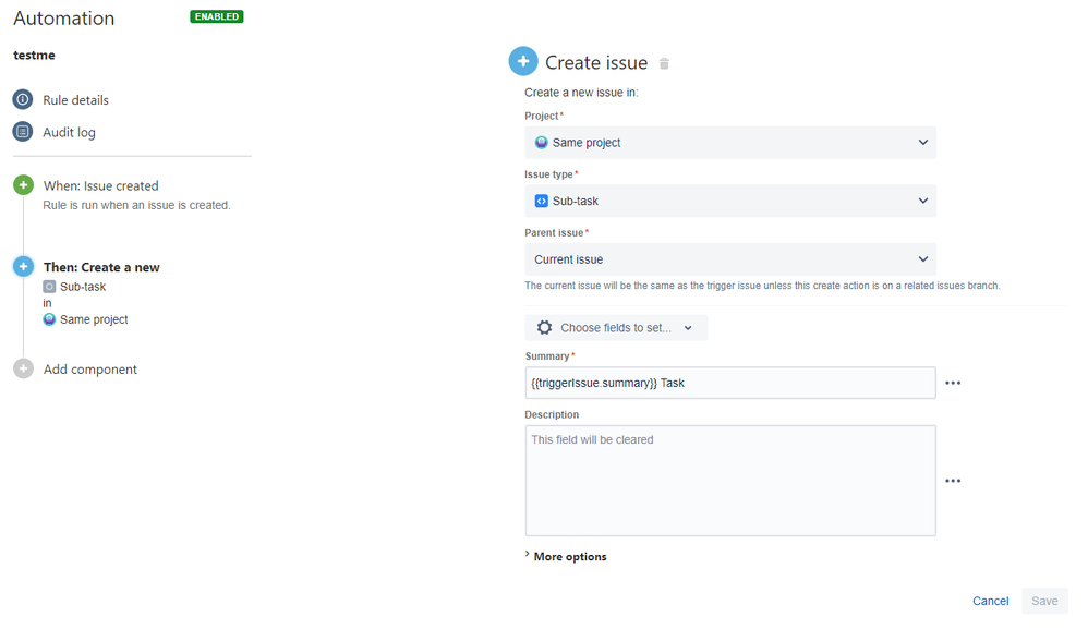

Can you try to specify the summary in the 'Then: Create a new' action like so (I hope Cloud automation has it as well, I tried with on-premise so..):
((Note I changed it to '{{triggerIssue.summary}} Task'))
Pauline Hild
February 23, 2022
Okay, now I understand the problem. I changed it the way you did in my rule but it doesn't work yet. Is there anything wrong?
Radek Dostál
February 23, 2022
Hmm, then I'm flabbergasted, looks the same and it worked for me.
Does Audit log says anything interesting?
Pauline Hild
February 23, 2022
No, not as far as I can see. What I'm wondering about is that after I changed the rule it says "Rule successfully updated" but there's still a loading sign that doesn't disappear. Maybe that's the reason it doesn't work?
