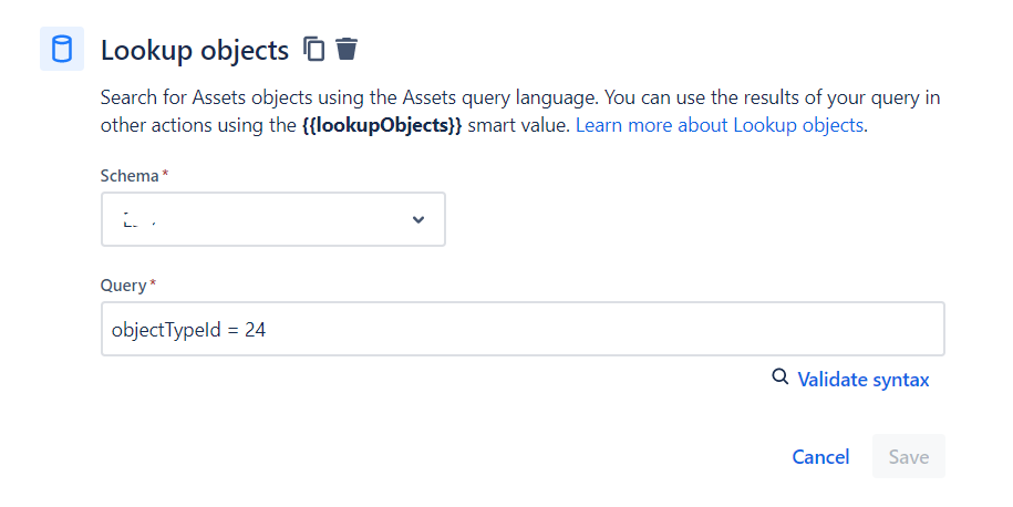

  2. Second, you need to query for objects matching that id value in a specific attribute. You can use a lookup objects action for that.  (and again, log the result if it does not work as expected)
    attributeName = {{issue.Request Type.requestType.id}}
    You can now create an if/else condition using that result to get different actions for the different outcomes. The condition being that the amount of objects returned must be more that 0
    {{lookupObjects.size}} greater than 0

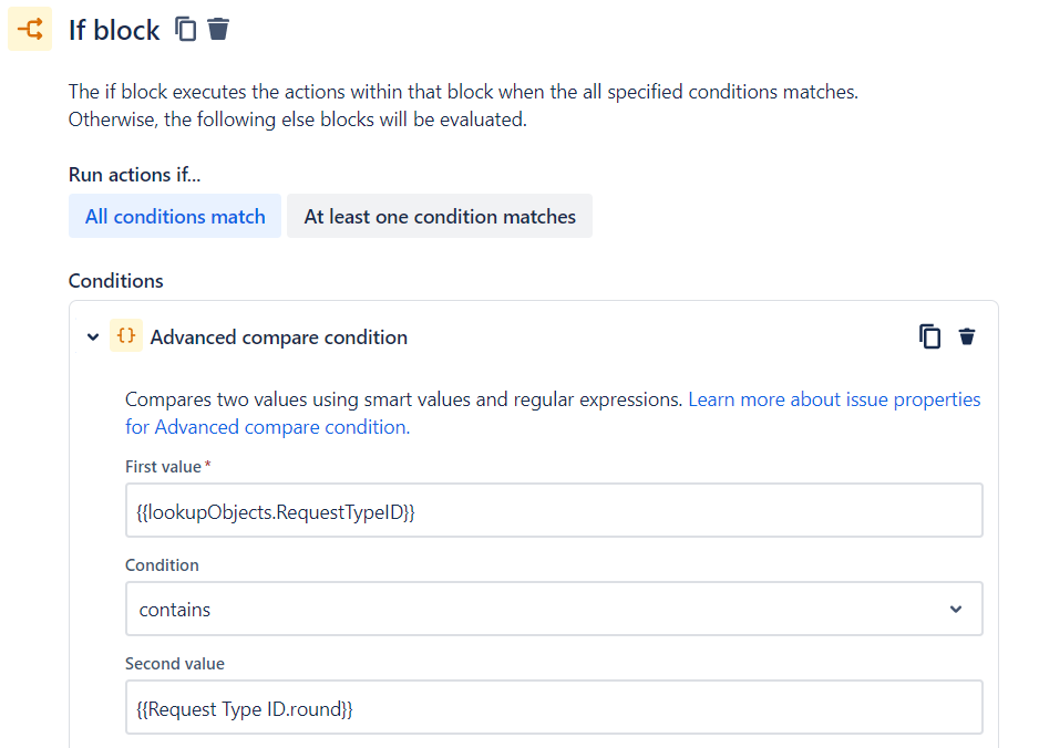

I lookup in Assets where my values to compare with are:

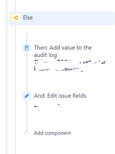

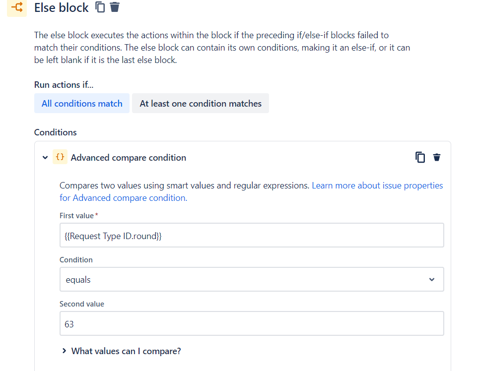

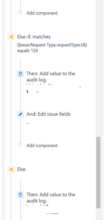

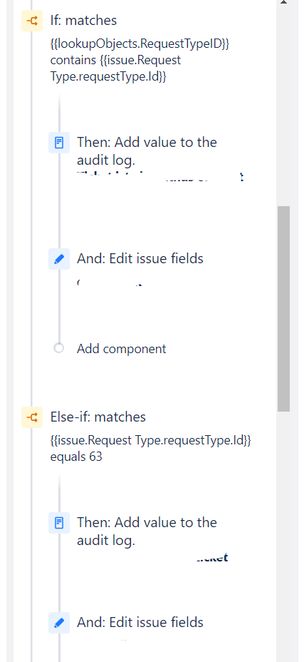

With that I can compare the ID of my issue (it is something like 11.0 hence the round) wiht the values from Assets. If the value is found I edit a custom field.
If not, I check in an else-if block, if it is another value. If the value is found, I edit a custom field.
If none of the above matches, I edit the custom field in a last Else block to a certain value.

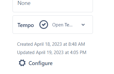

Right now, I am troubling with the trigger, that should go off, if there is a change of the request type or the request type ID.
When I do the change of the request type (not the issue type) in the ticket dialogue, the dialogue changes, but the ID does not change. I checked it by clicking on "configure". In the URL I still see the ID of the ticket as it was before, but in the ticket, the name of the request type has already changed.
Due to that, the trigger does not recognize the change and does not update the fields as it should.
Have you got an idea, what I should check? I am not excluding, that I still have a misunderstanding of request types and the ID that goes with it.

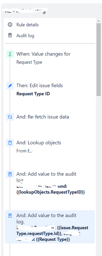

Hmm, in that case, have your trigger on the change of the Request type, and then do a "re-fetch issue data" action before anything else.

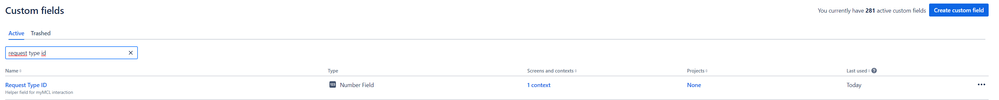

It seems, my "Request Type ID" custom field is configured as number, is it usually like that or how is it configured then?
As I used your suggestion from above {{issue.Request Type.requestType.Id}}, this gives me an integer-like value. I guess, you meant that initially in this thread, instead of a custom field "Request Type ID" of any kind?
Some automations fill and update that custom field, which explains the delay in the automation, which it is about in this thread.
The solution that works for our use-case looks as follows:
The trick is the first step to put the value from {{issue.Request Type.requestType.Id}} in the custom field "Request Type ID" and refetch data. With this I do not run into the timing problem. From then on, I can work as desired with the (integer?) value for the comparisons and updating the other custom field.
