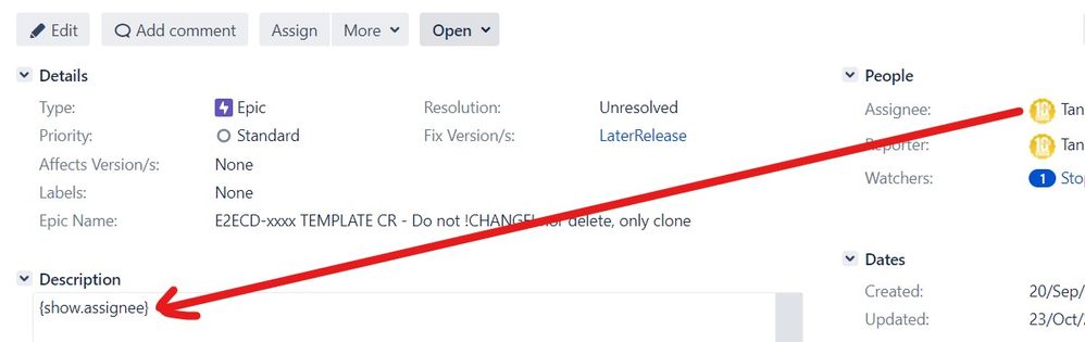

Hi all.
I would like to use the actual assignee in the description field of an epic like this:
unfortunately {show.assignee} does not work. ;) Is this somehow possible?
As background of the question: I would like to use this in a template. and then i'd like to print just the field 'description'.

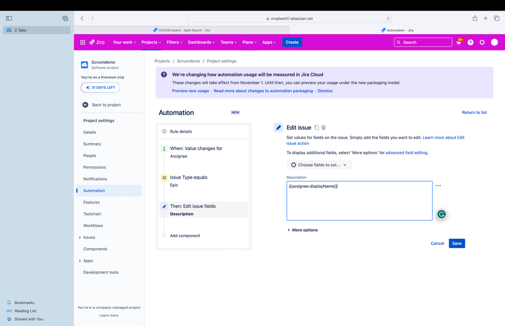

Hello, Good day. Please check if you could create an automation rule to edit the Epic issue type with following smart value.
{{assignee.displayName}}

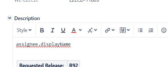

unfortunately this does not work. still this is shown and not the assignee's nameScreenshot 2023-10-24 085534.jpg

Please help me with your automation rule screenshot.

Hi @Stefan Tanner
Did you remove the {{}} brackets, they are required?

now replacing works. thx so far!
...but the whole description field gets replaced. In my second print screen you can see a table below "requested release / R92" this gets also replaced. Is it possible to not replace everything in the field "description"?

Hi @Stefan Tanner
Yes, that is possible.  Try including both smart values when you edit the issue in the automation rule:
{{issue.assignee.displayName}}
{{issue.description}}

better late than never: the answer worked! thank you guys!

Hi @Stefan Tanner
Yes this can be done.
In the rule in the description field, add the smart value: {{issue.description}}
This will keep the original description.
