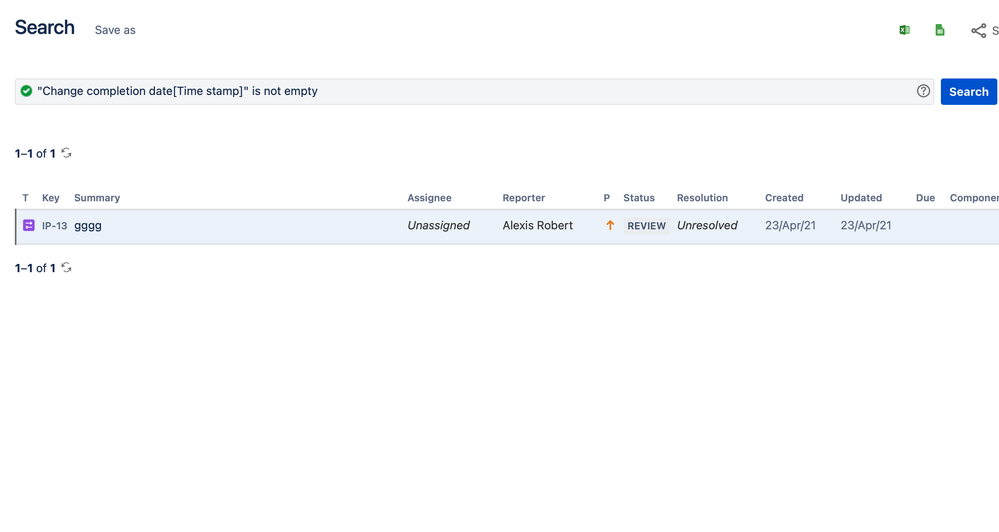

I'm not sure why it doesn't work for you, I was able to test and confirm that I'm able to use the field name when doing a JQL search :
"Change completion date[Time stamp]" is not empty
You can see the query below :
Let me know if this helps,
--Alexis
