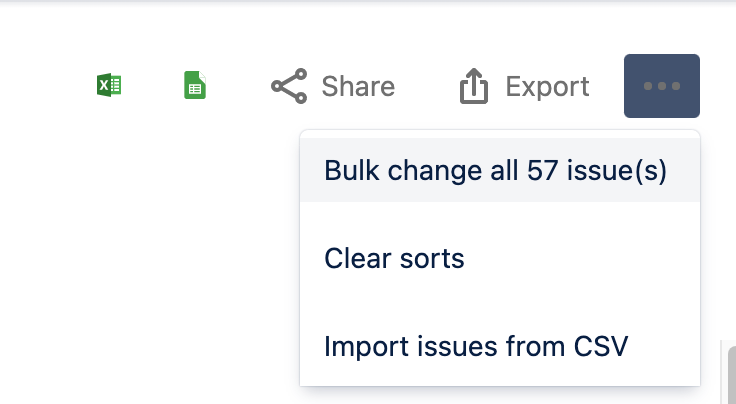

However I found a decent workaround:
After you upload your tasks, you can click the link to view them.
In this view, you can do a bulk change to set their Parent to the Epic you want.
It only takes maybe a few more minutes to do this extra step, so it's still pretty efficient.
For my use-case all of my tasks are generally assigned to the same Epic after I upload them, but I can imagine it being more tedious if you need to assign them to different Epics.

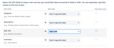

Hi @Fred van Beek
Can you confirm that the epic link field appears when you click the create button in JIRA?
Without this field appearing, you will not be able to import it since you are not the system admin of the instance and the basic import, follows the fields provided on the create screen.
See below from my test:
Regards.

Ismael Jimoh
June 3, 2020
The reason as I mentioned is your view is the same as that of someone who clicks create on the UI. You will only be able to map fields that are on the projects create issue screen.
The Admin view supersedes this assuming the admins know what they are doing.
To fix your issue, ask your JIRA administrator to add the Epic Link field to the create issue screen of your project.
Once this is done, you should be able to import epics.
