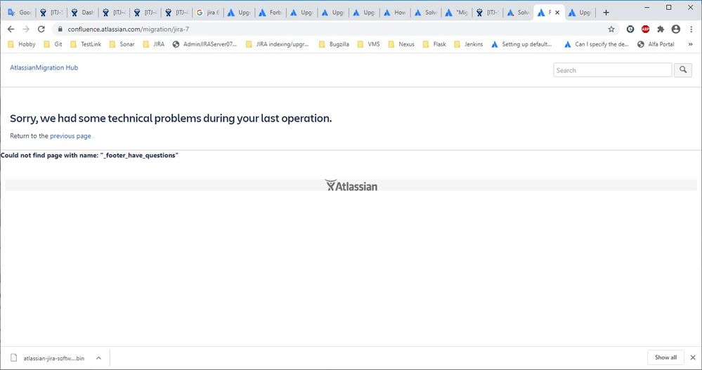

Colleagues, url to migration hub (https://confluence.atlassian.com/migration/jira-7 ) does not work now. I got message: "Sorry, we had some technical problems during your last operation.
Return to the previous page"
Where can I find info about migration 6.*->7.0.* ?

migration_hub.jpgThere is strange message.
