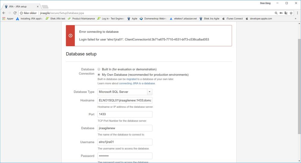

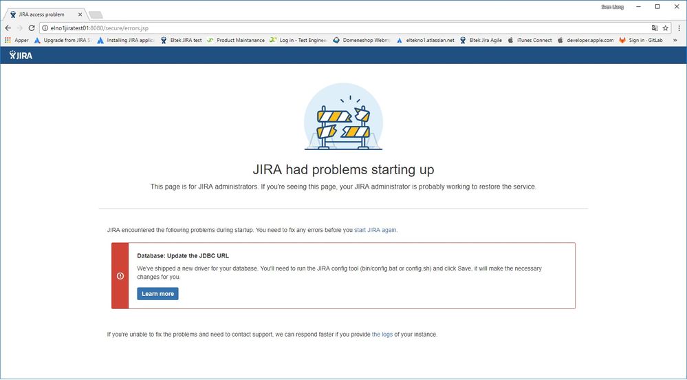

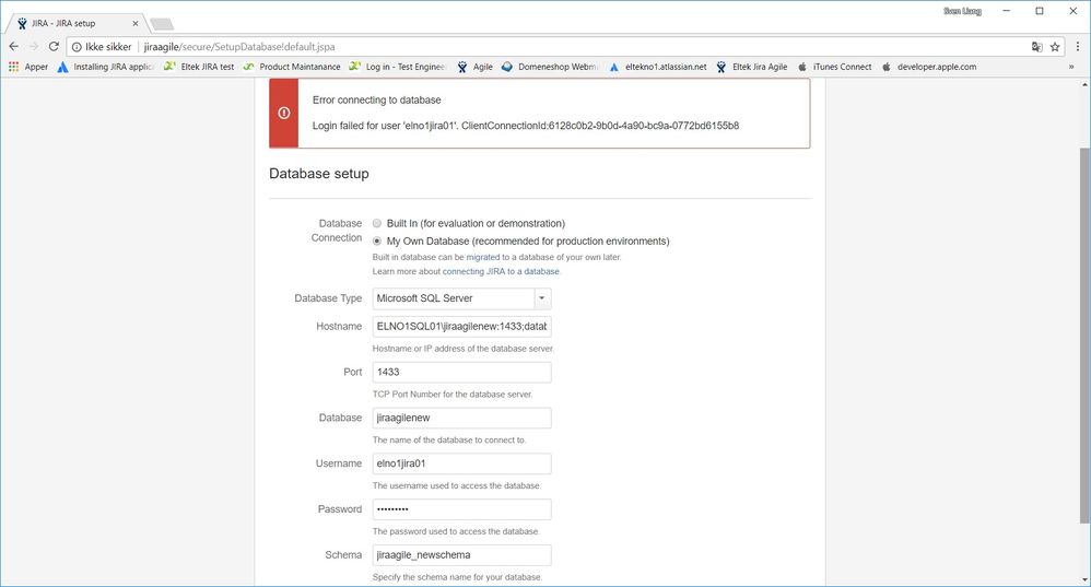

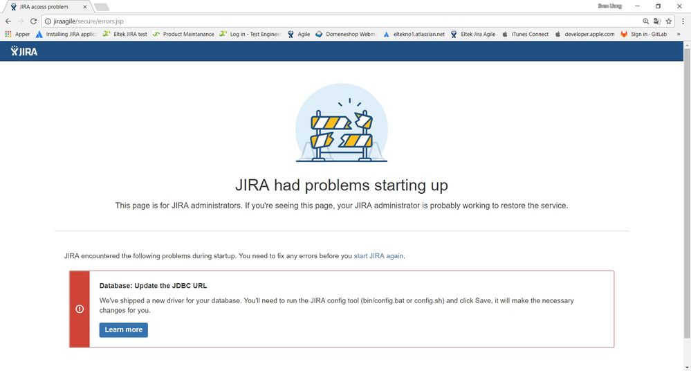

1.jpg was displayed when I uppgraded an 7.3.8 server version that was ok. I could access the SQL database (same as I later tried to connect to) before the upgrade
I tried  to edit manually (I don't like  JAVA on  our server) dbconfig.xml according to your instructions for manually edit. Think I got it right, but can not connect

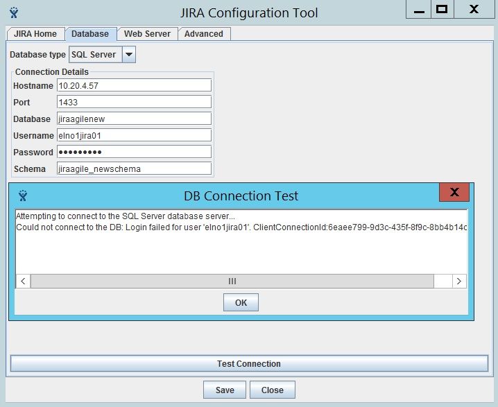

Then I deleted the dbconfig to manually reconnect in 2.jpg and 3jpg.
I then installed JAVA just to get similar error messages

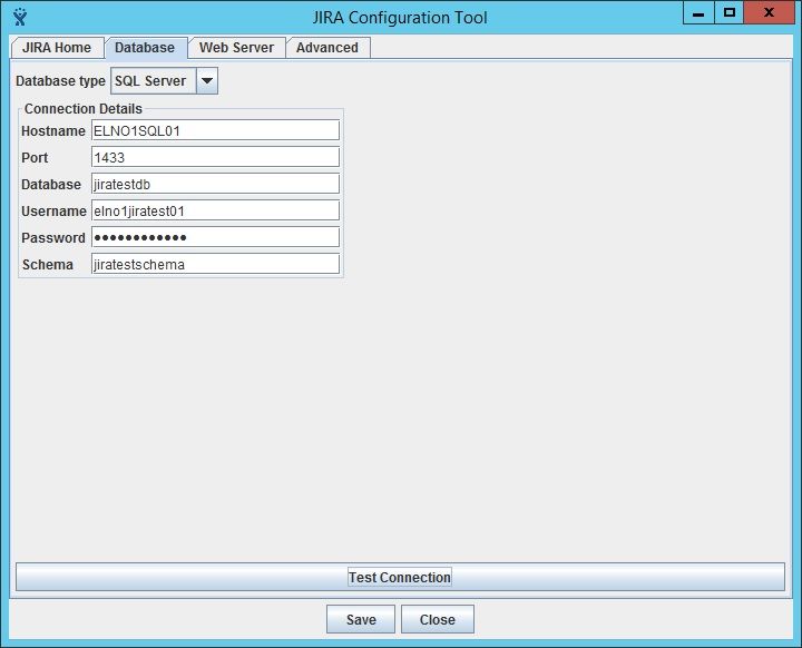

I have now run into the same problem for this database (SEN-9825988):
Attempting to connect to the SQL Server database server...
Could not connect to the DB: Login failed for user 'elno1jiratest01'. ClientConnectionId:901fdc3a-08d8-40c9-bf43-aa46527dd60a
