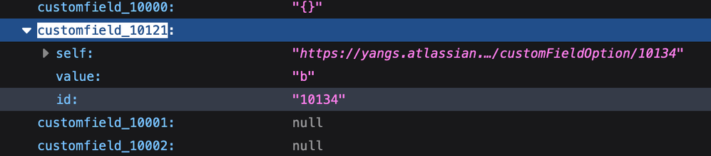

This is how my custom field values look like in the GET issue api:
The values that are available in the dropdown for this field are a and b

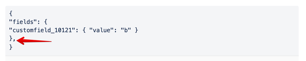

Hi @Nikki Zavadska _Appfire_,
The issue is your comma:
comma.png That comma should only be there if you were going to start another field.
There are some good JSON validators on the web that can help with this sort of thing too.

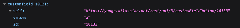

Hi @Simmo thank you for the answer! The comma confused me a little bit 🙈.
I just noticed that for the single select field this JSON actually works 👇
"fields": {
"customfield_10121": { "value": "b" }
